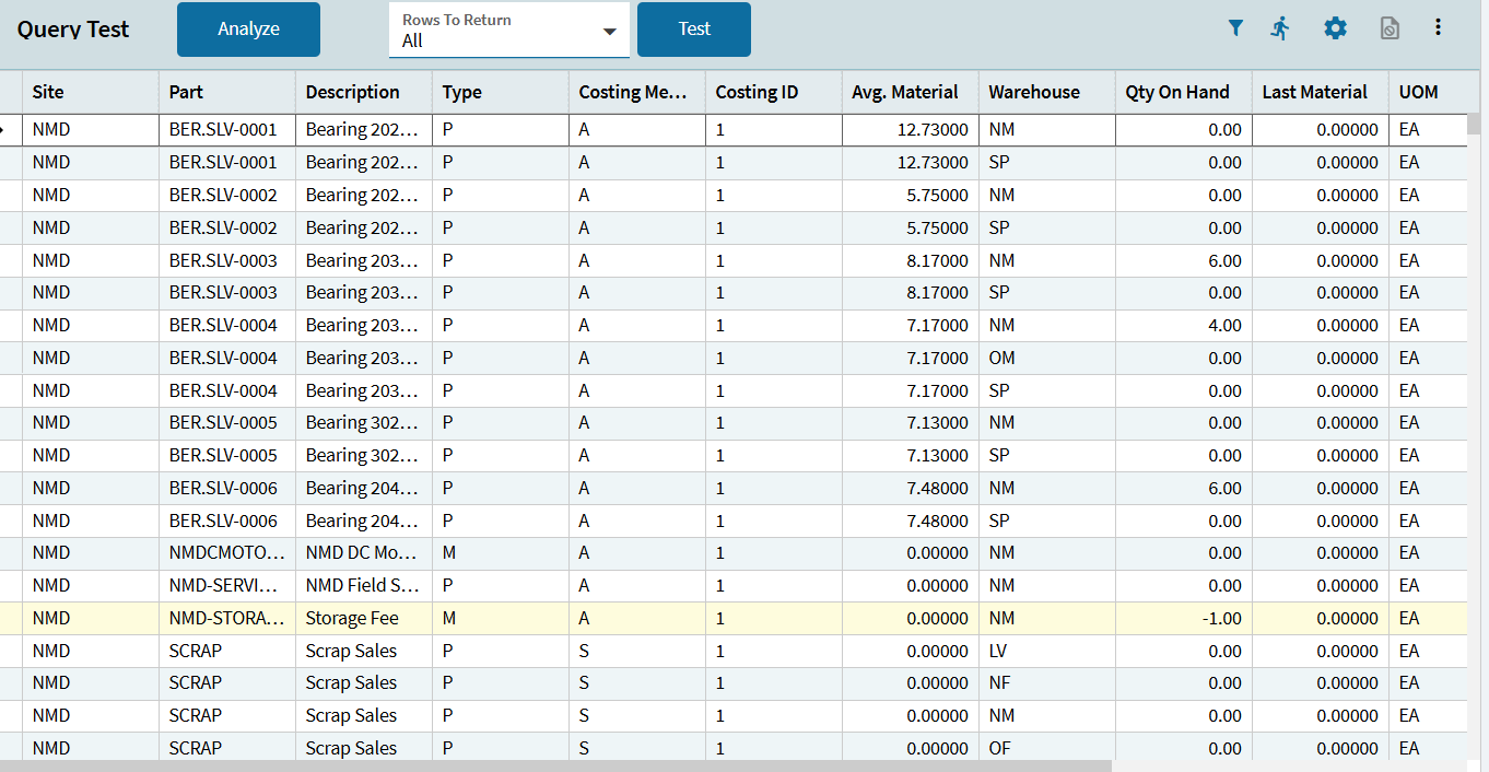

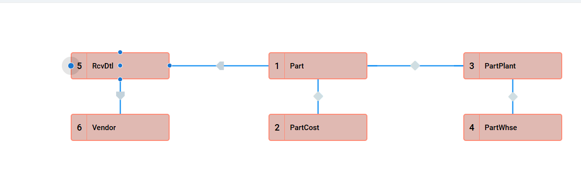

Current issues: I am receiving multiples of the same PartNum, this is likely due to no calculated field created for Last Receipt Date. Some purchased parts aren’t displaying the vendor or unit cost from rcvdtl/vendor, likely due to a join issue.

The PartDtl table has all the open demand and supply records for a part. So you’d create a subquery, and group by Company and Part, with a calculated field that is a SUM of the PartDtl.Quantity field. You need to filter the table using the RequirementFlag field. I can’t recall if demand = 1 or if demand = 0.
