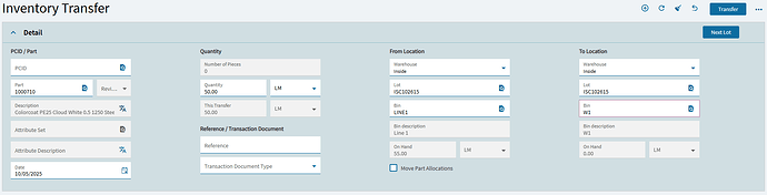

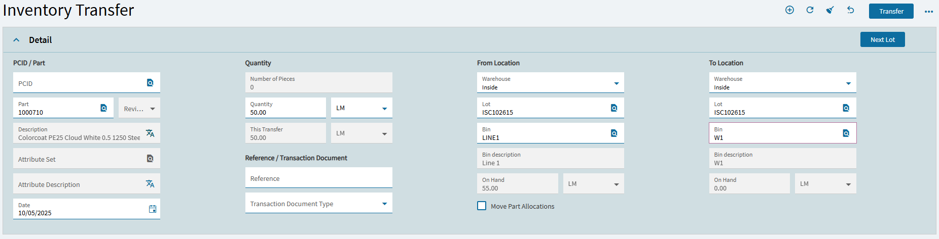

what i would like to do to keep this process still as simple as possible is to launch the inventory transfer app and have all the fields populated that are needed:
i have done launch form options before but passing values to a BAQ or gridview and filtering the data, or put a job number into a job traveller report but i cant seem to work this one out at all.
