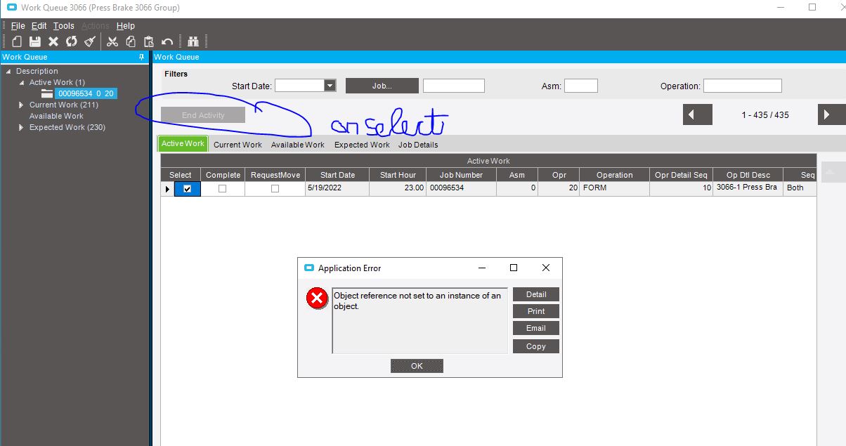

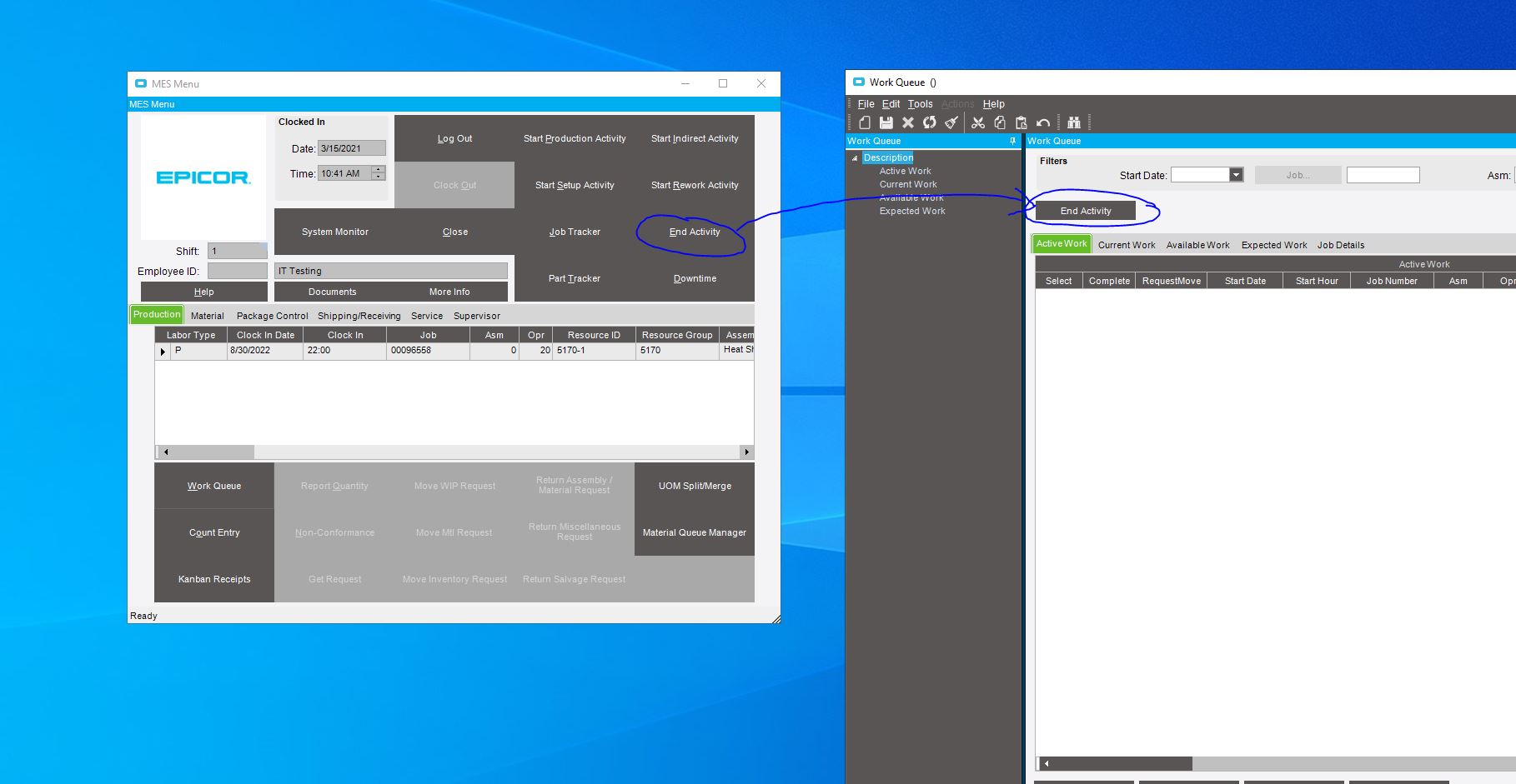

Hi, I am calling MES end activity form vi launch form on a new button click added in Work Queue form. but I got error “Object reference not set to an instance”
Can you help me how I can load the form with active work data?
My code is as follow:
private void btn_End_Click(object sender, System.EventArgs args)
EpiDataView edv= (EpiDataView)(oTrans.EpiDataViews[“ActiveWork”]);
LaunchFormOptions lfo = new LaunchFormOptions();
lfo.ContextValue = edv;
ProcessCaller.LaunchForm(WorkQueueForm,“OP-06.01”,lfo);
Please see attached error and button I added
