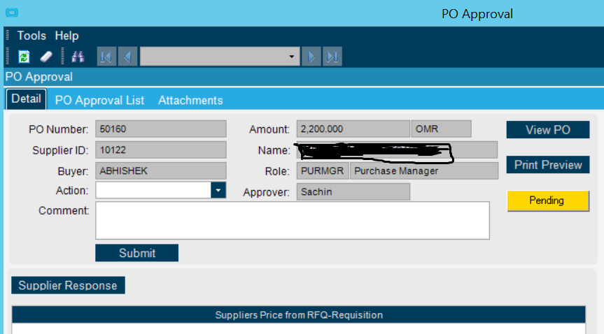

Yes, I have tried oTrans.Refresh but same result. I have clicked on the dropdown beside the binocular only one order is displaying refer to below screen
