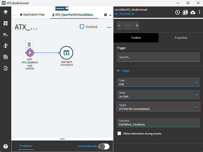

I am trying to setup a part number column in a dashboard grid to be a link that when clicked will open the Part On Hand Status module.

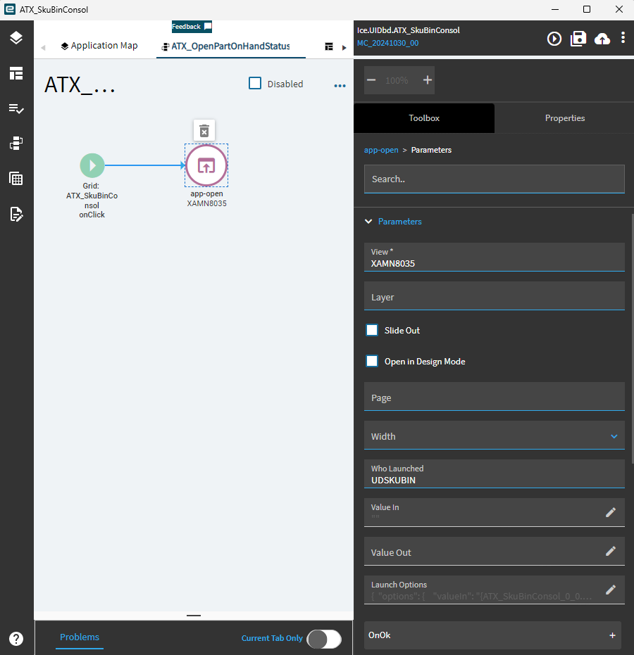

So far, I have been able to set the column as a link that opens the Part On Hand Status module. But I haven’t been able to figure out how to configure the launch options to pass the part number from the dashboard to the Part On Hand Status window. When I try to key in what I think is the column name in the dashboard, then the link doesn’t work anymore.
Here is the event that I have set up:
Is anyone able to help me figure out what the launch options should be?
