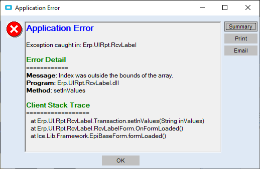

I’m trying to debug an error I’m getting when I’m calling the Print Labels screen from Receipt Entry. The call is custom through ProcessCaller, because I’m passing in some values that aren’t native to the form.
This is the error, I’m passing in size 3 string array. What I’d like to do is see exactly what the form is expecting when it’s called, because no matter what I send in I get this error, even a very large array.

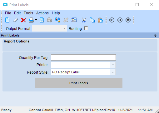

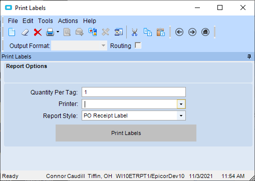

Well I didn’t get the error this time, but it broke the functionality of the Print Labels form. When the form opens it should default the Quantity Per Tag, and the dropdown on Printer should have the installed printers, but now it doesn’t have either.
Below is what it should look like, unfortunately I can’t show it, but the dropdown here does have the printer list.
you might need to set the epidataview values in the print labels form from your contextvalues object in order to get that portion to work, but at least you got the passing of the data resolved

Actually the data being passed wasn’t the problem. I should’ve said this earlier in the post, but the form works exactly as it should, the only issue is that error that pops up whenever you open the form. Even if I could just find a way to prevent that error from popping up, that would solve my issues.
It looks like the ValueIn method is expecting a string, and you’re passing it a string array. Perhaps it’s consuming it, but when you try to parse it in the form, it can’t index a string array when it’s been converted to a string. Hard to say exactly, but that’s my guess
