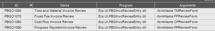

I built a BAQ to have a look at the Menu item form Arguments, it looks like the “Fix Fee Invoice Review” Menu item has a form that loads on top of the base program…
Does anybody know how to make lfo launch the correct form…
PBGO1070 = Fixed Fee Invoice Review
PBGO1060 = Time and Material Invoice Review
PBGO1080 = Cost Plus Invoice Review
PBGO1090 = Progress Payment Invoice Review
They all use the same base program but when you try and launch any one of them from an LFO only the “Time and Material Invoice Review” screen open regardless of which menuID

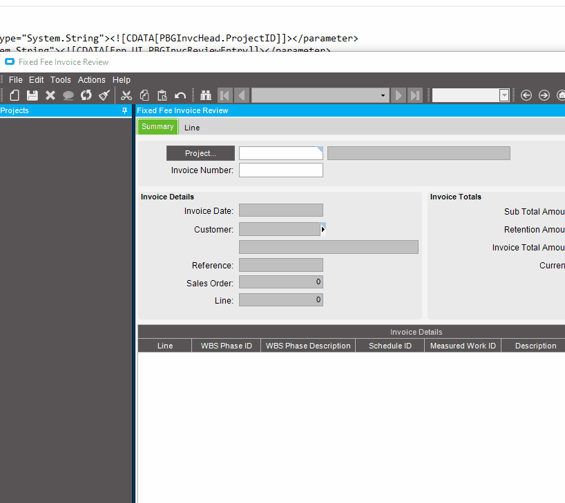

I think the problem is… to launch the approval form you need 2 variables one is the ProjectID and the other is the Invoice number, when launching from the Project Entry screen you only have the ProjectID to pass in,
I think I’ll have to work more on the search adapter which I sort of have working but it loads all of the results from all projects, I can’t get the PreLoadSearchFilter to work

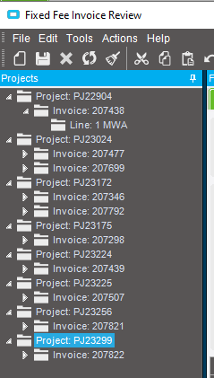

The gif below is what I’ve got to mimic
This is the code I’ve pulled together but it loads all results (the filter doesn’t work)

As per the gif, I need to do a search within a search, bugged if I know how to get that to work haha
