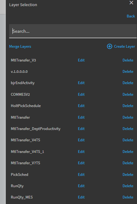

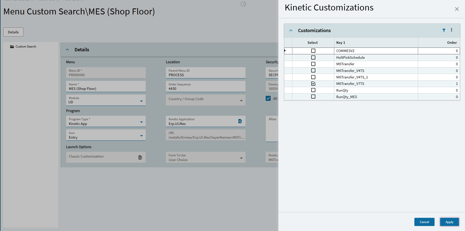

So, I prototyped some things in our Third environment which I then made a solution and installed on our live environment. The issue now is the layers are behaving strangely. I see them in app studio and am able to edit them, publish etc. But when I go into menu maintenance to assign the customization layer it isn’t an option to select.
The layer in question here is v.1.0.0.0.0

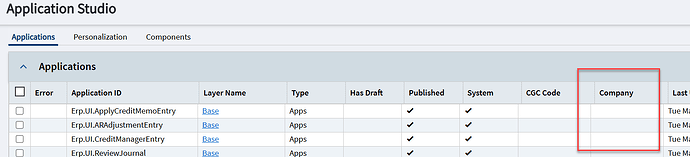

Is the layer Published? Is the owning company matching Menu Maintenance?
It’s definitely published. How would I check the owning company?
Application Studio
hmmm its a bit weird because the company is the same but the other layers all have T_ before the company and my layer doesnt

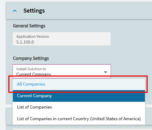

I ended up resolving this by switching the company settings when I did the install to all companies
