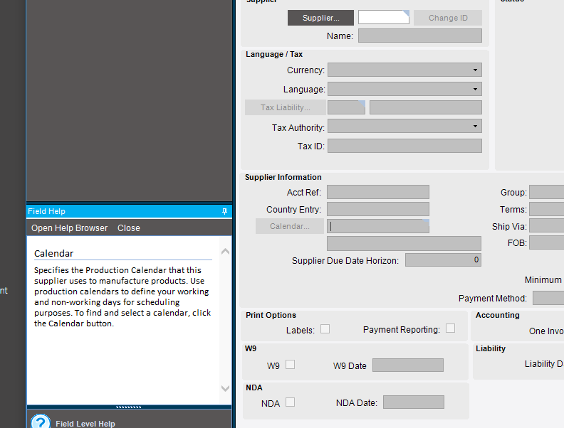

Apparently you specify a calendar for a vendor.
Which I would only ever do if they were a critical vendor and had differences with your normal calendar. Like if the do a plant shutdown for 1 week every year for maintenance, recognize special holidays (where they’re closed for more than one day), etc…
looks like you could set up a supplier calendar. I guess it would work great if you know your supplier was closed a week in summer or Christmas. We use some small shops and they close.
