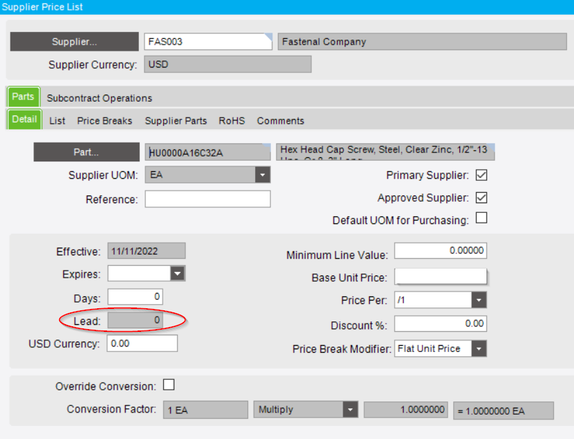

Hello all,
We have an unknown batch of parts that is not allow the purchasing team to adjust the Lead Time on the SPL. I have compared to fully functional part setups and can’t find the root cause. Example
Any ideas?

@mc9306 Here is the KB from EpicCare KB0122308 - Supplier Part exists and is marked Default for Purchase
This solved my issue albeit in a round about way. The flag was not set as true but a check, save, uncheck, save solved the field being locked out. Thank you Greg!
