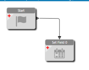

Trying to set lead times for parts with a BPM.
It sets it but on refresh of the part page it doesn’t seem to hold the value. It just reverts back to the inital value.
When I set it manually, it holds the value.
Am I missing something?
Got tired of it not working so it’s really simple. I only have the field setter in the BPM at the moment.

Data or Method Directive?
If it’s a pre-processing method directive it’s possible that there is something in the BOs base logic that resets the value. Technically when you add a new part l, the part plant record hasn’t been created until after the first update.
I personally tend to use a data directive to set default PartPlant values. Add a condition statement so that it only fires when the record is added.

Method directive. Post processing.
Base and Pre wouldn’t work.
I was gonna try data directive next. I had it all setup on conditions but it wouldn’t work so I ripped all that out.

The solution was to do a “in-transaction” data directive.
Boom problem solved. Thank you!
