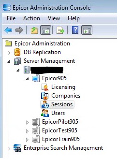

You can see that on the Epicor Administration Console under sessions.

You can see if a user is active or not by the color of the name icon or by the License column (In Use or Available)

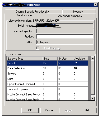

In the same place you can go under licensing; right click on your active license then properties. You can see how many in use and available at any give time. Also limit your users to Allow one session

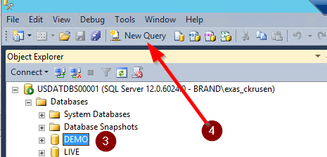

  1. Open SSMS
  2. Connect to the DB (Server Type: Database Engine)
  3. Expand the tree on the left to DB you want. and select it.

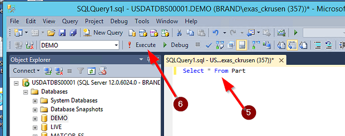

  4. Select New Query from the toolbar
  5. Enter the query in the center pane
  6. Click Execute
