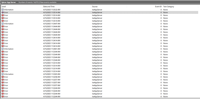

Our app server event viewer is full of these errors. There is at least one error per minute, and it always seems to be triggered by the SysMonitor.

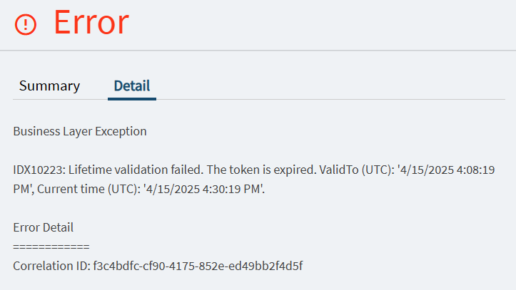

Anyone have any news on this since last September? This is such a pain… I’ve found that if I have more than one Epicor tab open in the browser, and one of those tabs goes inactive for period of time, it triggers this issue and kills my active tab/session.

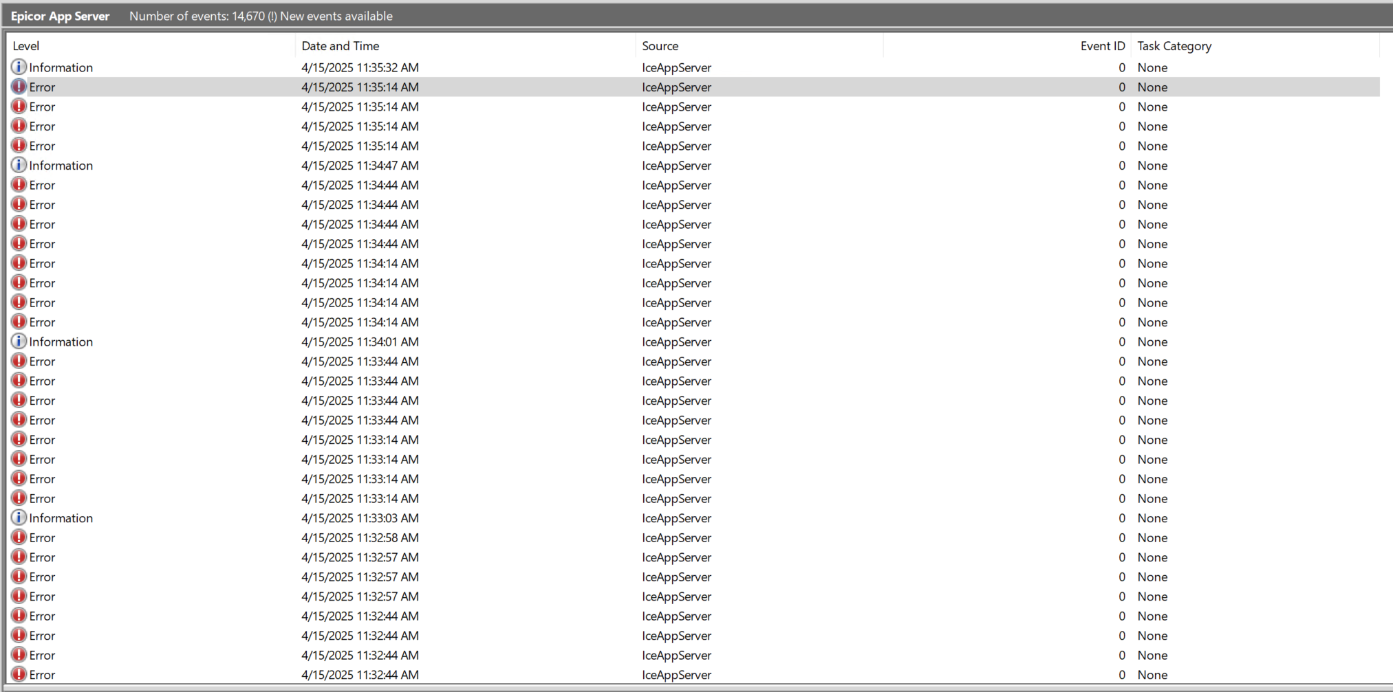

App Server Event Log:
99% of the errors are this error… it’s just full of noise and makes the Event Log almost useless.

Yes, this happens quite frequently for us if a browser tab goes to sleep or a user shuts the lid on their laptop and leaves for the day.
There is a reoccurring AJAX request that is supposed to silently refresh the auth token, but if the browser isn’t active, it can’t do this. This message is what it falls back to if it can’t get the new token.
Remedy this by creating a policy to prevent browser tabs from going to sleep (see this if you use Edge). Also train your users to sign out at the end of the day, even though that may seem to be impossible.
On our Kinetic test user, I’ve disabled tab sleeping in Edge (tab icons no longer go grey), but they still get the IDX10223 Failed: Lifetime validation failed error. A full refresh (Ctrl - F5) typically resolves it. We’re Azure SSO. The user typically has several Epicor tabs open simultaneously.
