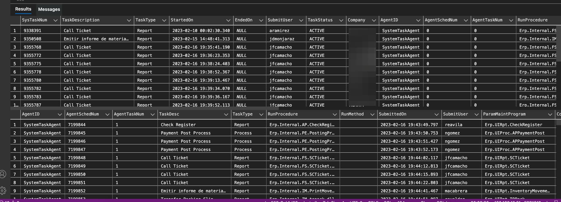

did anyone solve this problem?
I think I have a bit desperate user
The solution is to upgrade - I don’t know exactly what version they fixed this in, but now if you go to submit the same report again, it pops up and tells you to wait.
Thanks, I saw this in last Kinetic update I’ll search whats versión have this option, actually in 10.2.600
