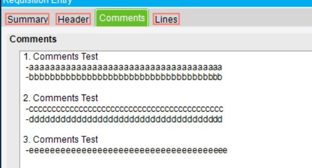

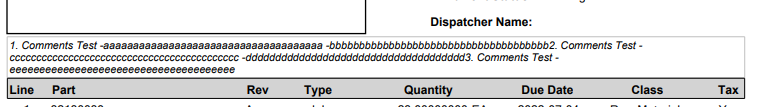

I’m very new to Epicor, but I’ve modified the SSRS Report with your help here in the community. My issue I encountered along the way was that the line breaks in the Comments I entered in Epicor did not appear in the output.
I changed the line with Enter key in Epicor as shown in the screenshot below, but the line did not change on output.
How do I fix this? Does the Report Builder handle this? Or is it done by Epicor? I would be very grateful if you could tell me how to fix this.

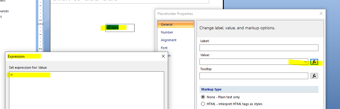

Please try below in SSRS Expression, change the column name from ‘Fields!Calc_LineDesc.Value’
=Replace(Fields!Calc_LineDesc.Value,Chr(13),Chr(10) +Chr(13))
Sorry to bother you.
Where is the SSRS Expression located?

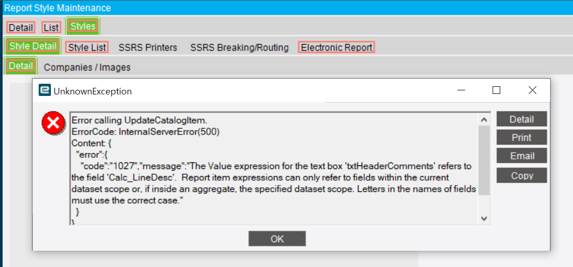

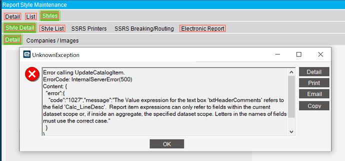

After modifying SSRS Expression as you said, when uploading report, the following error message pops up. What’s the problem?
You have to give the correct column name in the expression.
With your help, this issue is well resolved.
