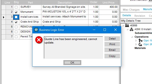

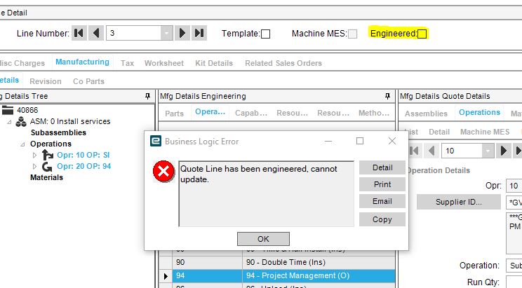

I’m using Kinetic 2021 (11.1.100), estimating custom products for lines in the Opportunity/Quote Entry.
I’ve un-Engineered the lines, saved, and the went to update an operation. However it claims that the line is still unengineered. This has happened fairly frequently, and I was wondering:
Has anyone else encountered this?
Does anyone have any idea how to prevent this issue?
Is there any way my layout could be causing this failure
Please let me know if there’s any additional info I could provide to help figure this one out! Thank you!
Funny, I just ran into this. For me, I had to uncheck “Quoted”, save, then go to each line and uncheck “Engineered” you are on Line 3 in this picture, so go to each line, uncheck Engineered and save after each change to make sure you are not wasting efforts.
Luckily I’m only editing the one line here. I do always uncheck “quoted” and engineered on the line.
It just seems to sometimes not want to stick even after saving.
