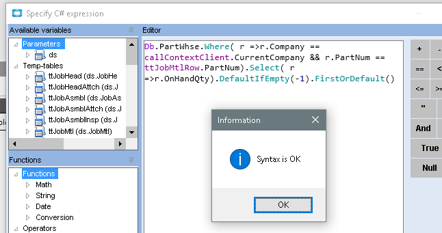

I get the following to pass a syntax check:
The variable you’re assigning it to is of type Decimal?
try removing .DefaultIfEmpty(-1) That is just there to give you a value (instead of null) if no records are found.
the -1 might look like an integer, when it is expecting a decimal.

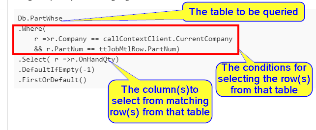

It might help to layout what is going on in that code…
The .DefaultIfEmpty(..) is optional, and can be used to set the value returned if, no matching rows are found.
The .FirstOrDefault() instructs it to return the value from the first row (if multiple rows are found)
So you want to add to the WHERE part.

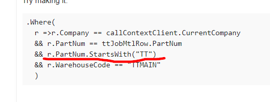

Try making it:
.Where(
  r =>r.Company == callContextClient.CurrentCompany
  && r.PartNum == ttJobMtlRow.PartNum
  && r.PartNum.StartsWith("TT")
  && r.WarehouseCode == "TTMAIN"
edit
FWIW - hard coding values like “TT” and “TTMAIN” is generally bad practice (but gets the job done).
So I would like to limit the PartWarehouse to only parts beginning with TT but not sure on the syntax. Searching to see if I can figure it out.
The r in the expression represents the record from the table (PartWhse in your case)
So the line highlighted above limits the records to look at to ones where PartWhse.PartNum starts with “TT”.
