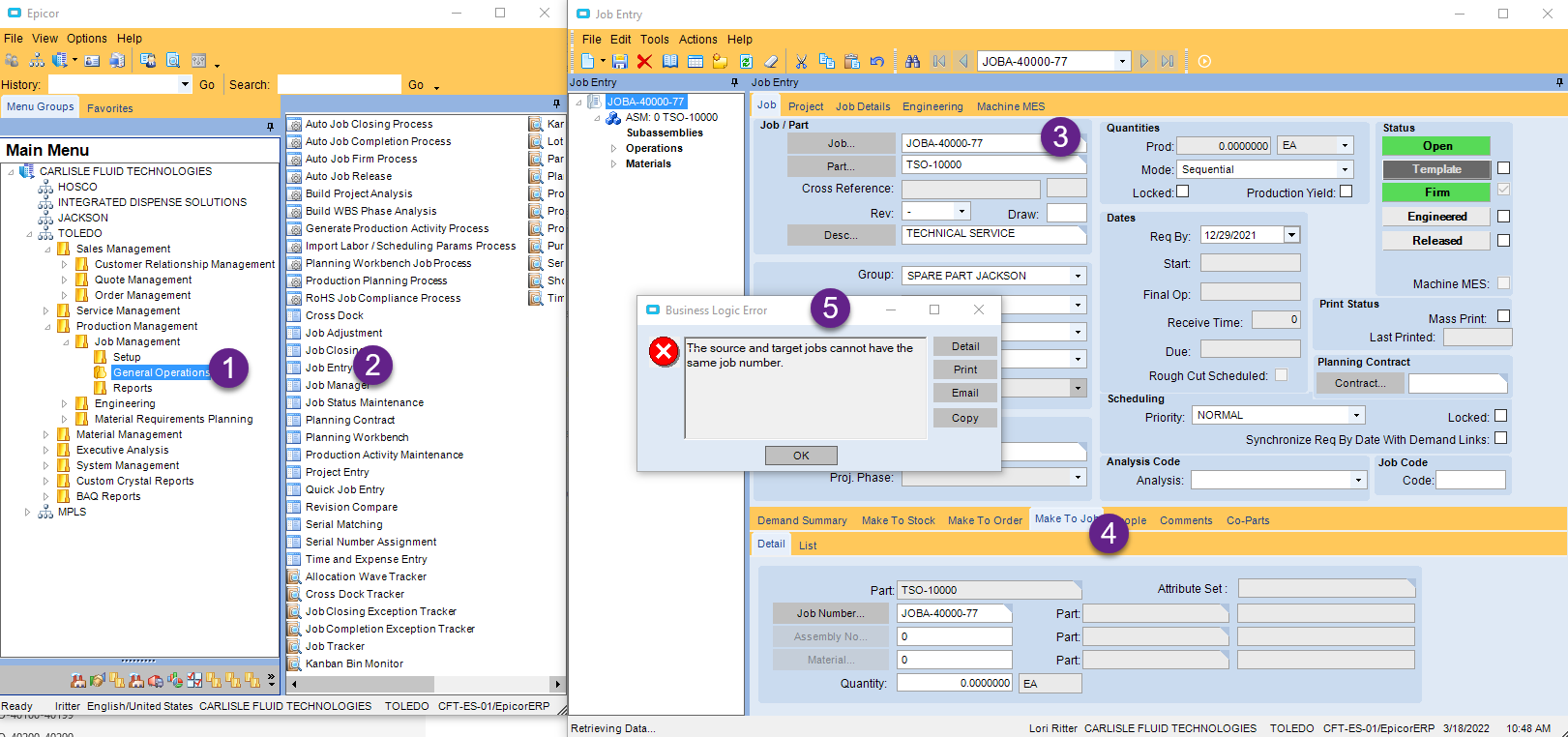

We do not have the option to go to Service Management > Field Service > General Operations > Service Job Entry.
So, I followed your second recommendation to go to
  1. Production Management > Job Management > General Operations >
  2. Job Entry. I already created a Job = JOBA-40000-77.
  3. JOBA-40000-77
  4. File > New Demand Link > Make To Job and entered JOBA-40000-77 (because I did not know what else to enter)
  5. Received error message: The source and target jobs cannot have the same job number.
How would this connect to the Sales Order 430693?
