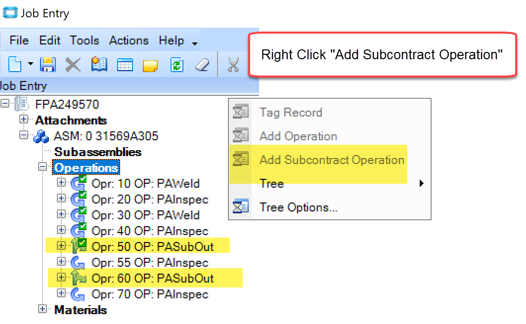

Subcontract operations will link into a PO as a Subcontract line type. Material requirements on a Job will link into a PO connected to the Job as a Material line item type. Is this what you are referring too? Line items on a PO cannot be Other or Inventory and connect to a Job.
We’re having issues when doing this. When adding the job to the PO, we receive this error: Material/Operation is not on file or it has no pending purchase requirements.
