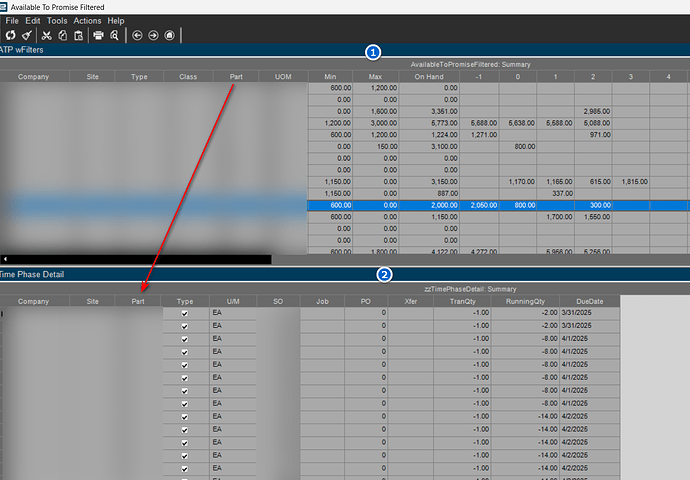

Oi - I am toying around with a new dashboard, and have two separate queries in the same dashboard.
I would like to link the two, but am unsure how to do so. When I select a line on Number 1 window, I would like for Number 2 window to only display details associated with the same part # selected in Number 1 window, updating as I click through different lines on Number 1 window.
Right now, I have filters applied to query Number 1, but none applied to query Number 2.
I would imagine I do not need filters on Number 2 if 1 and 2 are properly linked.

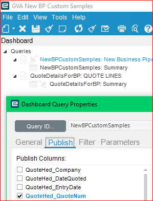

Right click on your first query → Properties → Publish tab and select PartNum for your case.

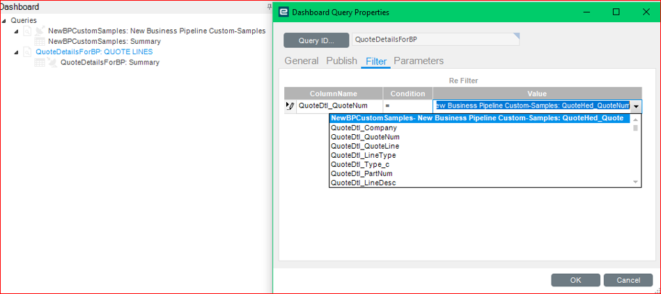

And for your second query → Properties → Filter and select the published column from your first query.
This did the trick, thank you!
