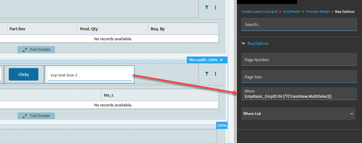

I would say you’ll probably need a button to fire this off since finding a trigger may prove challenging.
But on that button click, you would need to loop through the selected items using a dataview-condition widget. The iteration event would need to format the values to each be wrapped in single quotes and comma-delimited and then save that to a TransView field of your choosing.
Then you could use the IN operator on the Where clause to filter on multiple values.

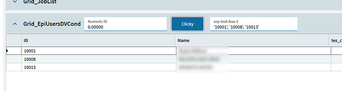

Here’s an example where I typed in the values because I was too lazy to set up the pub/sub and events. :sweat_smile:
