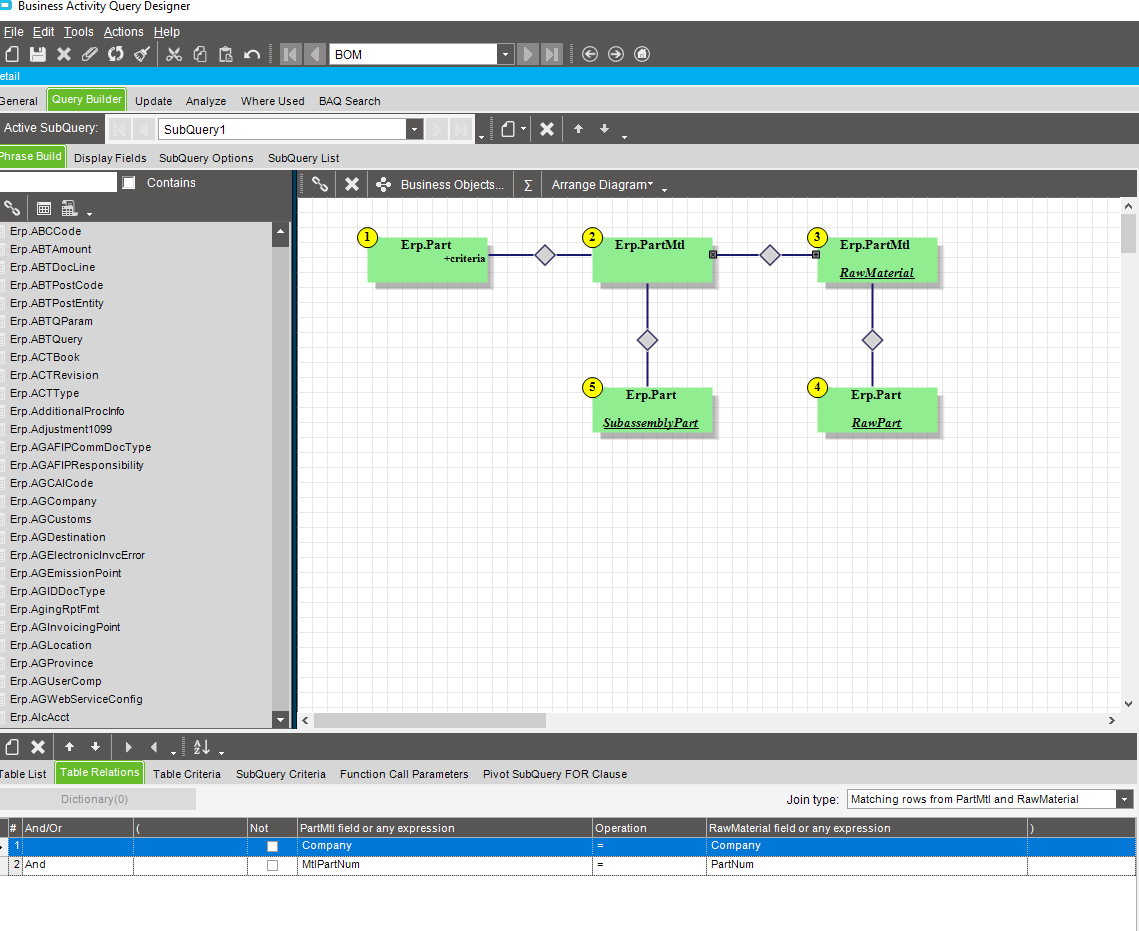

I’m trying to create an Indented BOM Dashboard. Our products have a few subassemblies so we would need to go down a few levels. Is it possible to link a table to the same table? I am trying this with the PartMtl table. It links it ok but returns no data from the second PartMtl table. Is there a special link you have to create or is this not even possible? Thank you
BOM.baq (25.2 KB)
Here you go my friend.

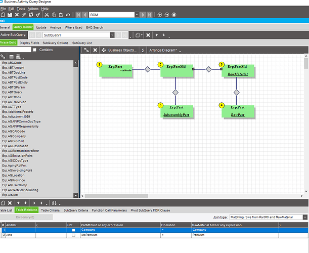

You need to link MtlPartNum from the higher level subassembly to the lower level PartNum.
Repeat the same link depending on how deep your subassemblies go.
