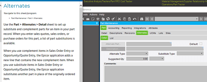

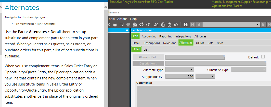

Not an expert on the topic, but think you should take a look at part alternates on the part maintenance screen
If you setup the the alternates as substitute, Epicor will warn the user that the part is being replaced. I really like to use run out with the substitute function.
