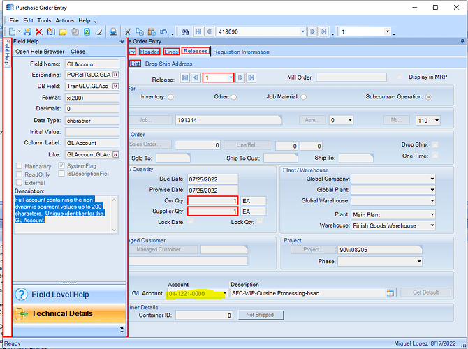

I need some assistance on how to link the TranGLC.GLAccount to PORel table. Shown below.

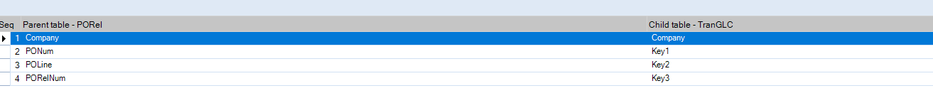

Below is the association I tried.

Those are the correct links for PORel.
Key1=PONum
Key2=POLine
Key3=PORelNum

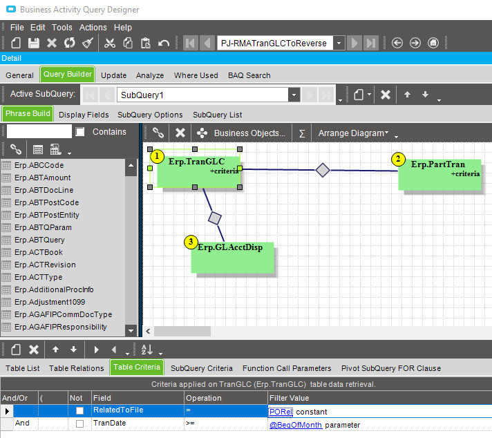

Dont forget that you need to filter the TranGLC RelatedToFile = “PORel”

The TranGLC is used to keep records for lots of files. You need to apply a criteria/filter to that table in your BAQ. The criteria should be TranGLC.RelatedToFile=PORel

Can you please explain me how to filter this TranGLC RelatedToFile = “PORel”
In BAQ designer, in the BAQ you are working on, Select the TranGLC table, and add a criteria to that table TranGLC = PORel
