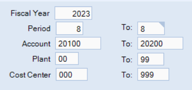

Here ia a baq that does that. I built it a long time ago and it will do any gl account. I use a dashboard to filter out the details. You will have to modify it to fit your GL segments and company calendar. It does take some training for accounting since the GL entry amount will be listed for each entry that makes up that summary in the wip recon.

This works an absolute treat, thank you so much Greg!
