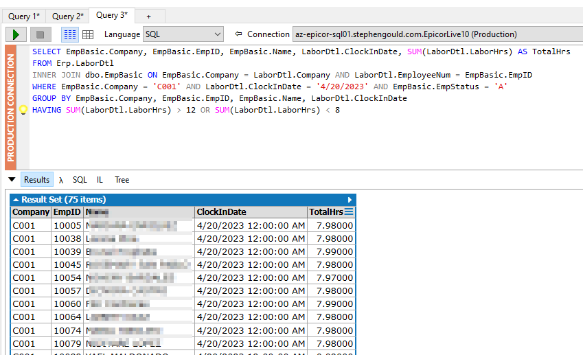

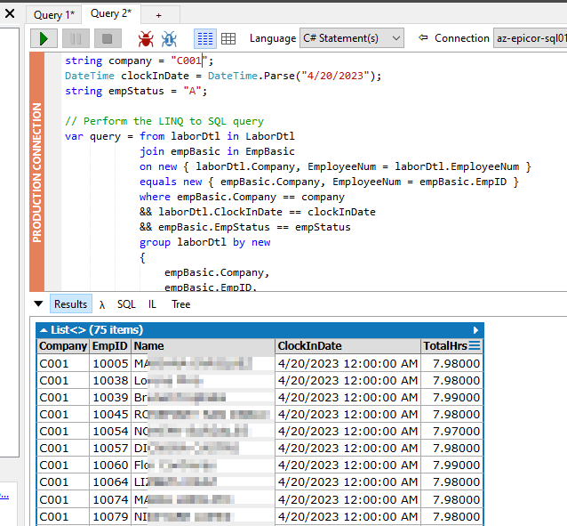

Note I didn’t test this thoroughly but it seems to work fine in my LinqPad
BTW that Linq I just gave translates to this in SQL thank you LinqPad

And I did verify just now that your original query returns the same results as this at least through the first few lines
