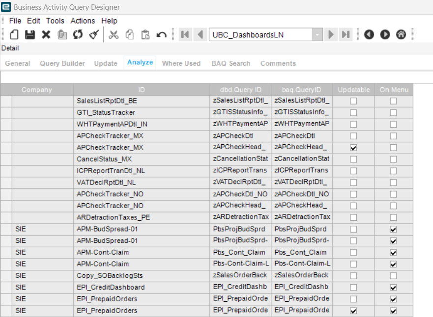

We are currently working on testing out our BPMs, Dashboards and Reports for our yearly upgrade. I need a list of all BPMs, Dashboards and Reports for all of our companies. Currently when I go into Solution Workbench, it only shows me data from the company I am logged into. How can I get a list of this data for all companies?
This dashboard is fed by various BAQs starting with UBC_, you can probably copy these and remove the company = @curcomp criteria.

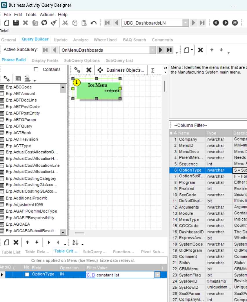

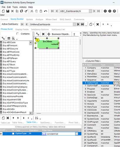

Thank you for that. I tested using UBC_Dashboards and there is not a company = @curcomp criteria. I only see this:
Hi, Take a look at the “Query Text” for guidance where the criteria lives, you are looking in the subquery but the criteria is at top level:
from Ice.QueryHdr as [QueryHdr]
right outer join Ice.DashBdBAQ as [DashBdBAQ] on
DashBdBAQ.QueryID = QueryHdr.QueryID
and ( DashBdBAQ.Company = @CurComp )
left outer join OnMenuDashboards as [OnMenuDashboards] on
DashBdBAQ.DefinitionID = OnMenuDashboards.Calculated_DashboardID
I see it now. Didn’t realize I was not in the Top Level query
It seems like removing that criteria didn’t help. It is still only showing current company and just blank companies.
Example:
Seeing Blank company (these are not company specific objects that apply to all companies) means that you should be able to see all companies’ data. Is “All Companies” and “Cross Companies” checked on the BAQ? Are you maybe over 10k row limit?
