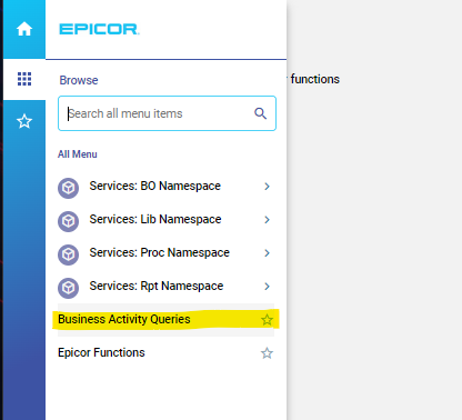

Are you familiar with the OpenAPI/Swagger page for Kinetic? It is located here:
https://yourServer/yourInstance/apps/resthelp/#/home
BAQs and Epicor Functions have their own execution endpoints. The business objects that are related to them are for the maintenance of the BAQ or Epicor Function, so you won’t find them there.
