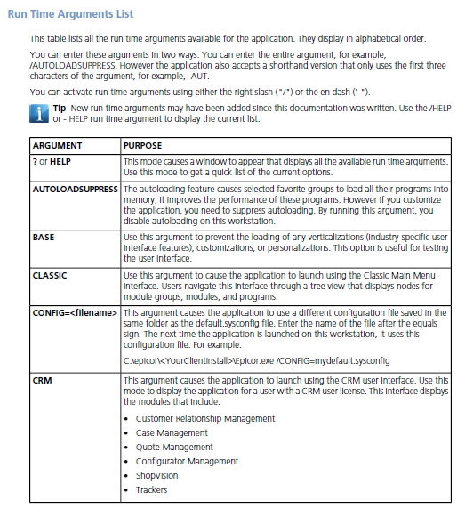

I know about the following: /config - which sysconfig file to use /MES - use MES version
/MESC - use MES customization version
/MEMORY - with memory leak tester enabled
Oh nice didn’t know you could do that. Here is what that showed.
(the popup has your typical .net programmer lack of nice formatting … it’s the little things…)
/SKIPCHECK - skips version check /UPDATE - skips version check and runs update /DB - loach the dashboard instead of main menu /AUTOLOADSUPPRESS - skips the automatic load of UI applications /MENUID= -starting menu ID
So there are some like /MEMORY that are undocumented.
There are some other little ones I remember from E9.
Argument
Description
AUT
Ignored. Used by other parts of the application.
BAS
CON
Followed by the configuration file name to use. If no path is specified then the “config” directory is assumed.
DB
Use the Dashboard menu.
HH
Use the Handheld menu.
MES
Use the MES menu.
OD
Use the Object Designer. ICE SDK Required
OPT
Runs AutoUpdate.exe with the /Optimize command line. This causes the appropriate client assemblies to be put in the native image cache (NGen) and / or the global assembly cache (GAC). You must be an administrator on the computer to run this.
PER
RPT
Use the printer that defaults in Crystal Report when the Print Dialog is opened. It can either use /rpt or /rptCrystal as a switch.
SKI or TEC
Skips version checking.
UNO
Runs AutoUpdate.exe with the /Unoptimize command line. This causes any assemblies that were optimized to be unoptimized.
UPD
Forces the client to be updated.
? or HELP
Shows how the command line works. This must be the first command line argument.
I think there is now also /classic and there was one to open up the player to replay ATE Scripts.
/active - Starts with Active Home Page, I think Modern and Classic are options as well. /CRM starts with CRM License /HH starts with Hand held /TE starts with Time and expense
