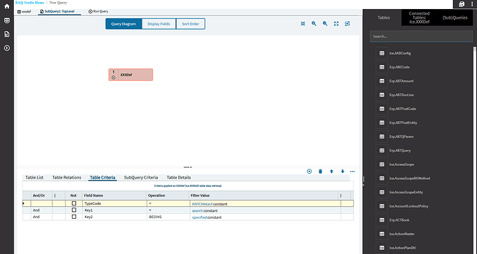

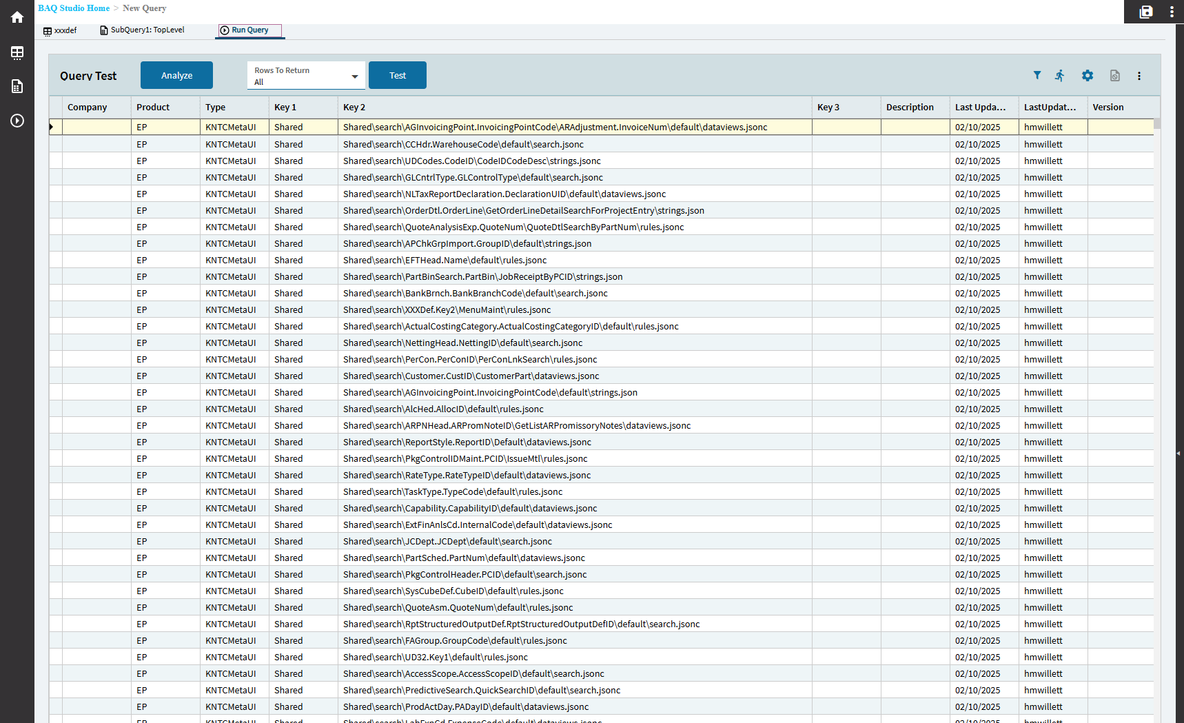

But for us Cloud folk, where do we find the list of existing searches available to use?

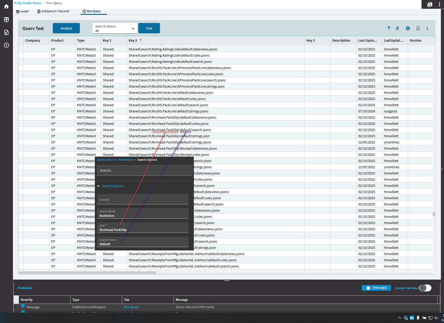

TypeCode = "KNTCMetaUI"
Key1 = "search"
Key2 BEGINS "Shared/search"
Key2 LIKE "%search.jsonc"

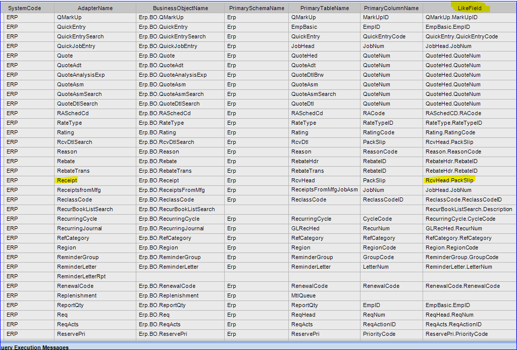

Another potentially useful BAQ would be against the Ice.AdapterXRef table:
So, if you wanted to add a search for Receipts… you would see that the “like column” for that is RcvHead.PackSlip:

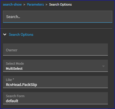

So that’s what I would attempt to use in your Search-Show:
Can’t say it would be 100% accurate, but again, could be a potential source of information.

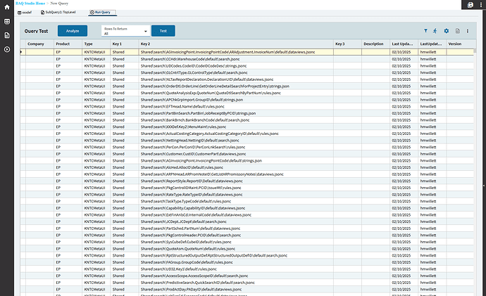

I just realized it doesn’t show you the table criteria I added.
Key1 = “shared”
Key2 Begins “Shared\search”

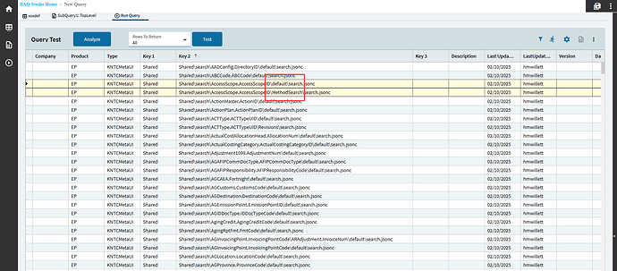

XXXDef is 100% accurate because that’s the source of the info. The search folder in MetaUI gets moved to XXXDef when you run conversion 191.
It’ll even show you if it has alternate searches available outside of default.
