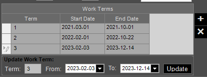

I am using UD03 to store employee work terms.
Key1 = employee ID
Key2 = Work term (1,2,3,…,n - keeping the UD03 rows unique for each entry)
Key3-5 are not being used.
Date01 = From Date
Date02 = To Date

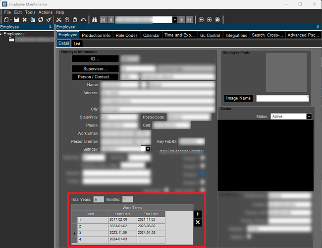

In Employee Maintenance I have a table to show work terms as well as add/remove work terms.
To save these work terms to the UD03 table, initially I wanted to use an adapter in customization code, but it’s tough to find the right events. The ToolClick event for SaveTool only works when saving normally, not when exit with saving.

Storing in CallContextBPMData from customization code:
private void populateCallContextBPMData()
	JArray items = new JArray();
	for (int i = 0; i < this.epiWorkTermsGrid.Rows.Count; i++)
		items.Add(new JObject() {
			{"key1", this.epiEmpIdBox.Text},
			{"key2", this.epiWorkTermsGrid.Rows[i].Cells["UD03_EmpBasic_WorkTerms_Key2"].Text},
			{"date01", this.epiWorkTermsGrid.Rows[i].Cells["UD03_EmpBasic_WorkTerms_Date01"].Text},
			{"date02", this.epiWorkTermsGrid.Rows[i].Cells["UD03_EmpBasic_WorkTerms_Date02"].Text},
			{"delete", "FALSE"}
	for (int i = 0; i < this.termRowsToDelete.Count; i++)
			{"key1", termRowsToDelete[i].key1},
			{"key2", termRowsToDelete[i].key2},
			{"date01", termRowsToDelete[i].date01},
			{"date02", termRowsToDelete[i].date02},
			{"delete", "TRUE"}
	JObject collection = new JObject();
	collection.Add("items", JArray.FromObject(items));
	// set bpm value
	var edvBPMData = this.oTrans.Factory("CallContextBpmData");
	var edvBPMDataRow = edvBPMData.CurrentDataRow;
	if (edvBPMDataRow != null)
		edvBPMDataRow["Character01"] = collection.ToString();
