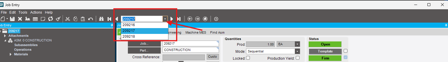

Hi All,
In the classic interface, in job entry we were able to load multiple jobs and filter through them easily. Does anyone know how to do this in Kinetic?

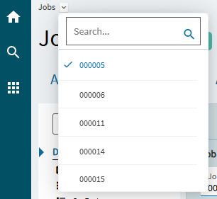

In Kinetic, there’s a tiny little dropdown arrow at the top (crumb bar).

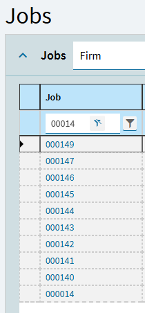

This is going to list all jobs that appear on the landing page. If you filter the jobs on the landing page (by whatever filters you apply), then open one so Job Entry form loads…
You’ll see that list updates to whatever your landing page filtered list was:

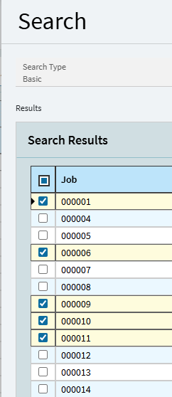

Another method is to perform a Search on the landing page and make your selections there:
Again, this pre-filters the landing page and those jobs then become your list in that dropdown once you go into the Job Entry screen:
