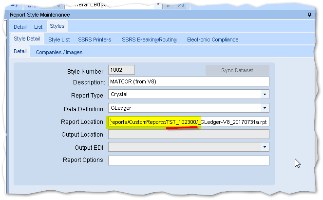

Or should I make sub folders for each environment, and then add that folder name to the path in the Report Style Maintenance?
Like putting all the CR .rpts for the Test environment (app name TST_102300)in
c:\EpicorData\CustomReports\TST_102300\
and
The later would be a pain when a report being developed in test needs to be implemented in the Prod environment. And when Prod is copied to test, all the CR rpts in Test now point to the .rpt’s in c:\EpicorData\CustomReports\PRD_102300\
