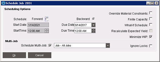

Logging options? job entry --> actions --> schedule --> job scheduling
Wondering if schedule details are logged when a job is scheduled via job entry?
–> actions --> schedule --> job scheduling
Currently, when I need to see more details about the scheduling decisions…

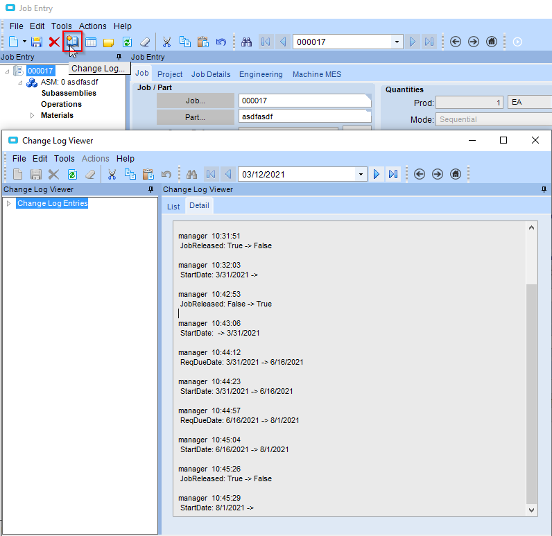

BPM Changelog.
Thanks, ChangeLog helps for some things.

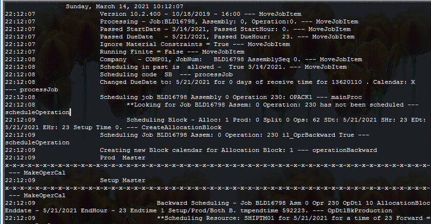

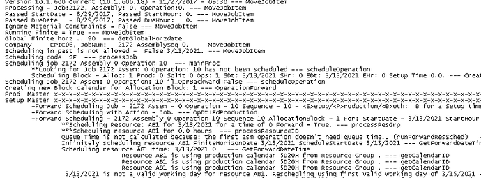

What I would be more interested in would be something like the logging options available when running MRP or Global Scheduling. When scheduling from job entry, I haven’t been able to find any logs… guessing they just don’t exist.
e.g.
@bordway in my version the file is in my EpicorData\Companies\YourCompany\Log\YourUser\ directory on the server.
You can also get them from the Server File Download Utility in E10 under the Companies choice.
Per the KB it is a setting in Company Configuration. Producton\Job Tab Scheduling options are at the bottom.
It looks similar to the MRP log.
