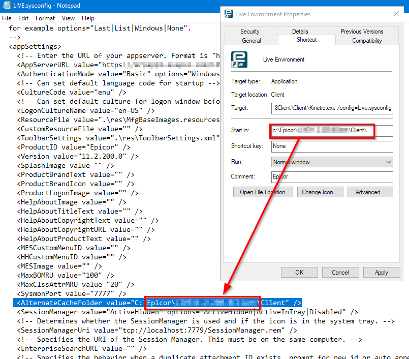

I know this has been idle for a bit now, but we have been experiencing this freezing issue after login for four of our users as well for several months now. We moved from 10.2 to 2022.2 in June and I suspect this started happening shortly sometime after. We’re on-prem. Has anyone else found a reliable solution for an on-prem situation?
Can you test if disabling system monitor from start on login will help those users?
Set this line in the sysconfig:
StartSystemMonitor value=“False”
I will give that a try. Thanks.
Olga,
I have tried the StartSystemMonitor value=“False” with a user this morning that had the freezing - blue spinning circle, and it did not resolve the issue.
