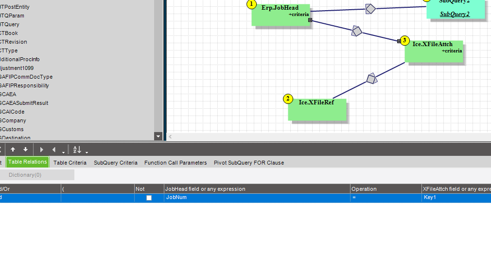

So how does XFileAttach link to the Job tables?
Working from vague memory. One of those tables stores how a link is related to a record (and what table\ etc), the other one has info on the actual attachment itself
Yup
and
Thanks a bunch guys! This is just what I was looking for!
