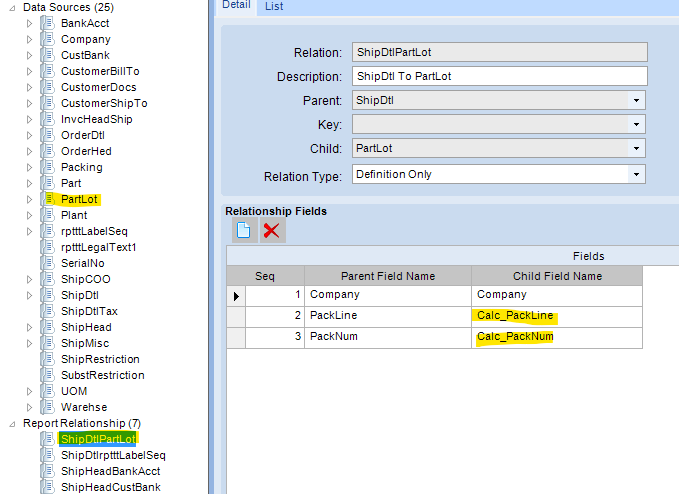

The PartLot table is already on the base PackSlip RDD, joined to the ShipDtl table.
However, it is being joined by using Calc_PackLine and Calc_PartNum columns… and I’m not sure how that table relationship is being used as it is not joined in the actual query. So, there are two routes I would try at this point…
Route #1: Use the existing relationship and hope it works:
Modifications to RDD:
  • If you’re not already working with a copy of the base PackSlip RDD, you’ll need to Duplicate the RDD.
  • Update the ShipDtlPartLot relationship to Relation Type: Output (instead of Definition Only)
  • You then need to un-exclude the ExpirationDate column (or maybe the ExpireDt column?). My company doesn’t use these fields, so I’m not sure which actually would store the date you’re after.
  • Save the RDD.

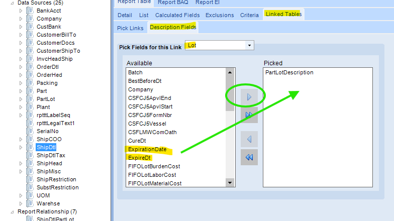

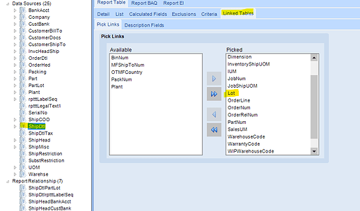

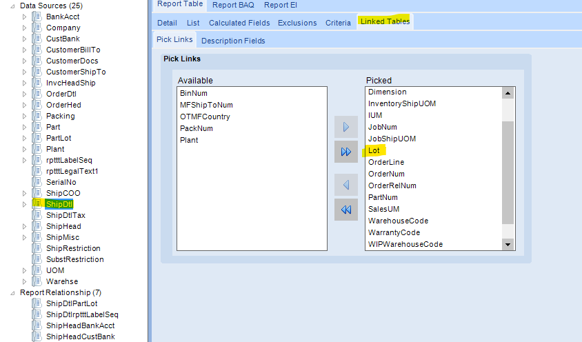

Route #2: Use the “Lot” linked table on ShipDtl:
Modify your RDD:
Again, if you don’t already have a custom RDD, you’ll need to Duplicate the existing RDD and save it as your own version.
If you look under the ShipDtl Data Source, it is already including the a “Lot” linked table. Based on the fields I see in there, I’m assuming this is the PartLot table.
Under the Description Fields tab, pick your “Lot” Table… and then move the ExpirationDate (and/or ExpireDt) column(s) from Available to Picked:
Save the custom RDD.
Modify your RDL:
In your PackSlip report RDL (In report builder). All you’ll need to do is add:
T2.Lot_ExpirationDate, just like you added T2.LotNum
Add Lot_ExpirationDate as a query field.
You should be set to add and use it in your report body.
Save, upload, test.
