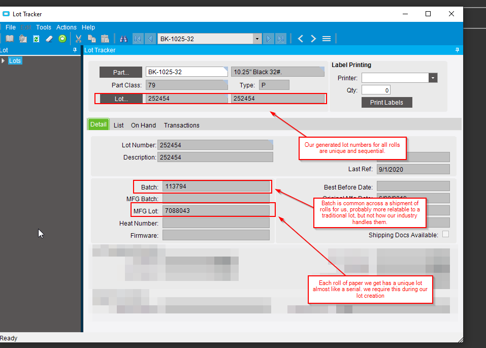

Would depend on your end goal. If you want to track for defect from MFG then use their lot. If you want to track for FIFO then maybe consider their lot in MFG Lot and generate lots of your own for internal processing.
We generate a new lot for everything coming (that we lot track) in so from a user perspective the format and familiarity is the same no matter the vendor.

How do you cross reference the supplier’s lot number with your own internally generated one?

We use their lot number because it matches what is on the manufacturer’s C of C. If a lot number does not exist, we use their packing slip number. If the packing slip number doesn’t exist, we use the first two characters of the supplier’s name plus the date the product was received as the lot number.
