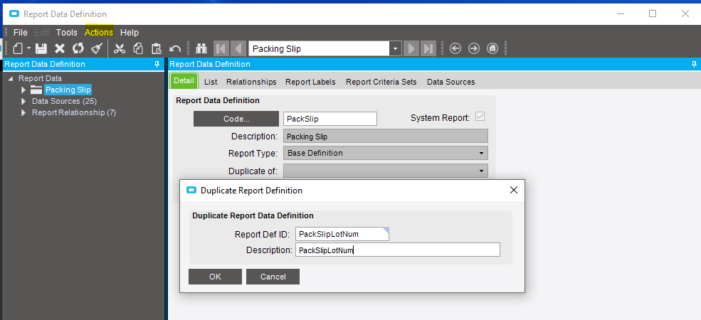

Open Base Report Data Definition.
Go to actions, duplicate report and type in new names

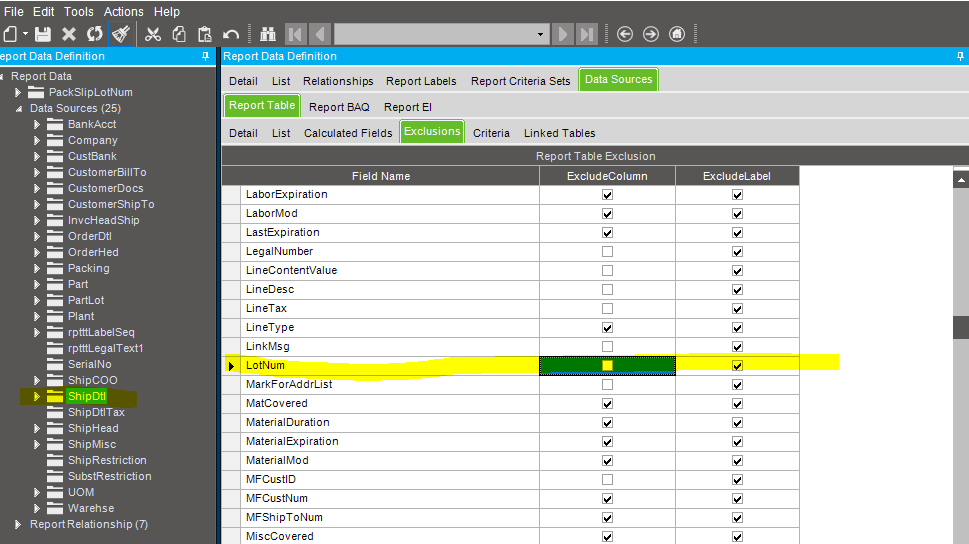

In your new copied definition, uncheck the “Exclude” box for the ShipDtl.LotNum and save.

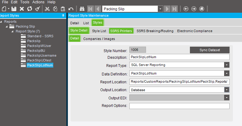

Go to Report Style Maintenance and open PackSlip report. Select the base report, go to actions, and Copy Report Style. Change the data definition on the new style to the one you just made.

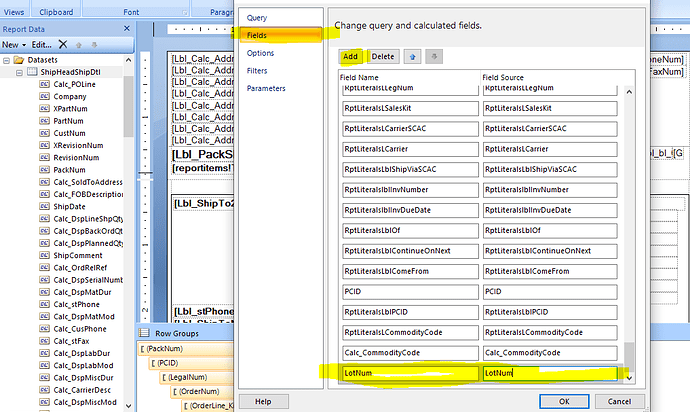

Open this new report style in SSRS Report Builder, and modify the quey in the main dataset to include T2.LotNum (the field you included in your new RDD)
Add a new field for what was added to the query.

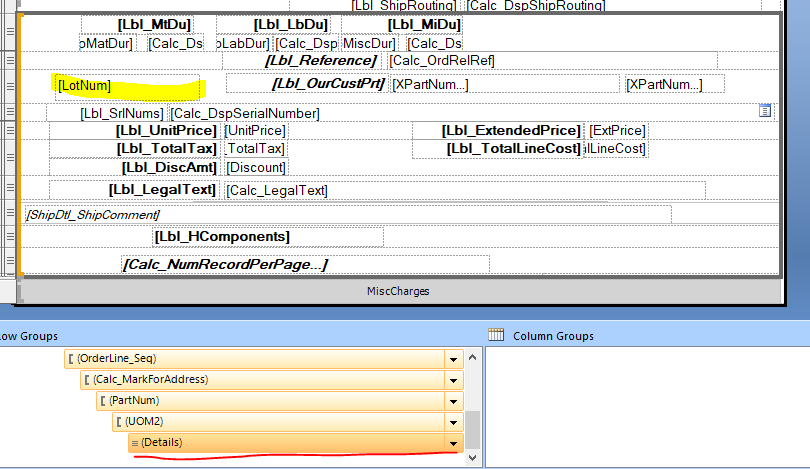

Now you should be able to add that LotNum as an expression wherever it’s needed in the report.
Save everything, and be sure to select the new report style when running the report.

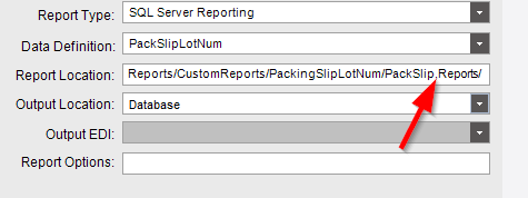

Keep in mind that there are 2 depending if you are shipping from the job or inventory
JobLotNum and LotNum.
And there are two reports for Packers. One for Packing slips and one for labels.
The comma in the Report Location field separates them.

There is a small twist in here. I got the lot number in the report. But in Shipment, we will have more than 1 line. How to bring the respective lot number of that line.
Example:
LotNum - 000185, Line 1, PartNum - 31906
LotNum - 000215, Line 2, PartNum - 75540
LotNum - 000195, Line 3, PartNum - 42020
Subha
It should already work that way, depending on where you put the expression in the SSRS report though. Where did you put your LotNum?
If you haven’t already, try placing it in the “Details” group.
Yes Adam I got it. Thank you so much.
