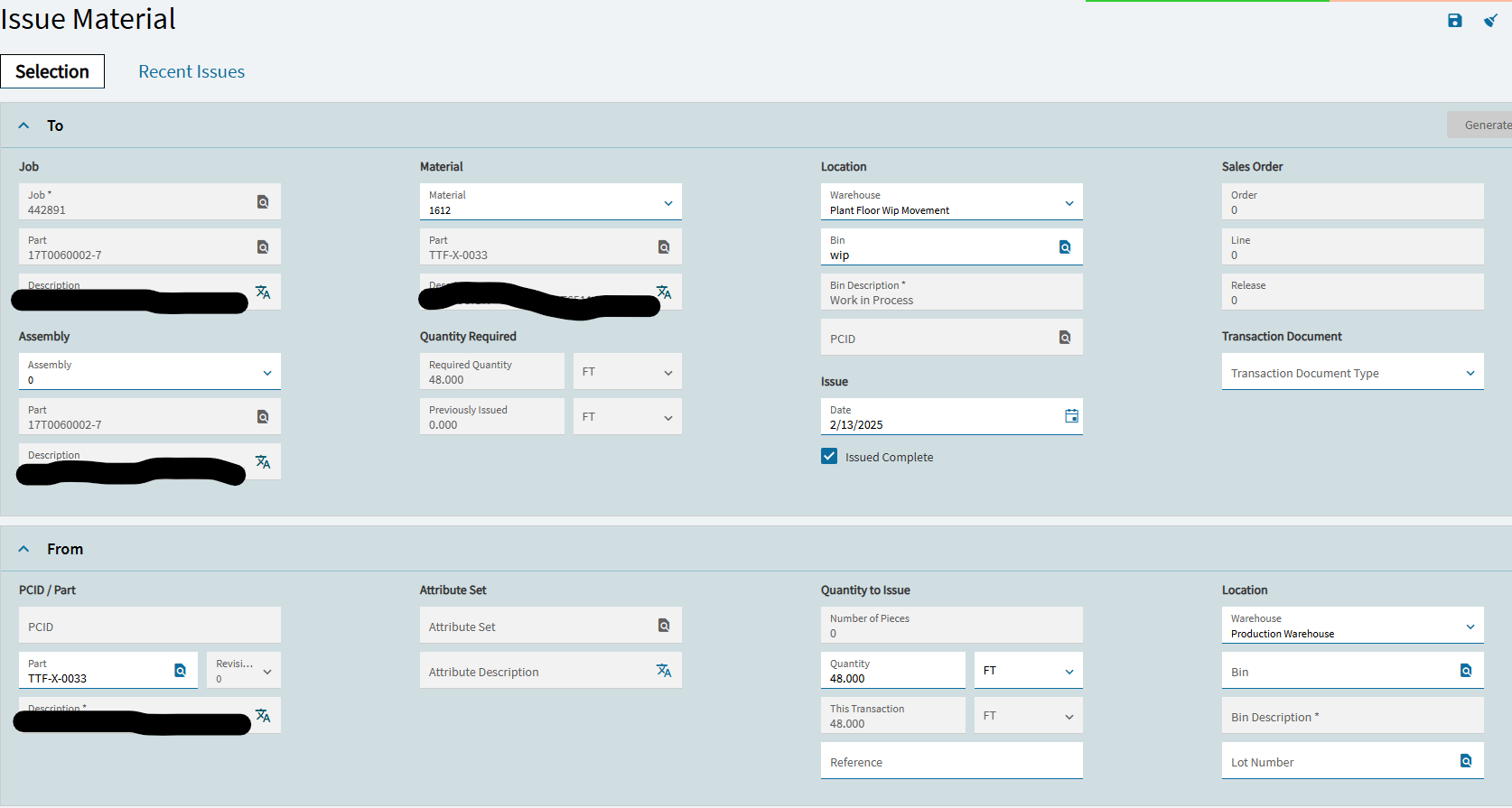

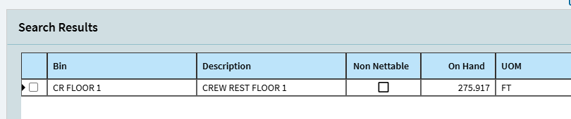

We lot track most of our parts and lately have been seeing odd behavior while issuing material. For a (currently undetermined) number of parts, our expeditors stated the lot number would not come up in the Search and they have had to go to part tracker, find the part and its correct lot #, and then manually enter it in the From lot number field in Issue Material. Upon manually entering the lot, it would take it and issue it. However, today for one particular part (so far) it won’t accept the lot even when manually entered. We get the error “a valid lot number is required.”

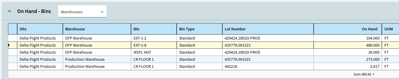

I was able to replicate the search behavior with this particular part both in Issue Material and Inventory Transfer (transfer let me manually enter and process without error) in our Test environment (so not environment specific). A couple of months ago we did add another warehouse and this particular part and lot is split between our warehouse and production warehouses. I thought maybe that was the issue, so I transferred the quantity for that lot all into the same warehouse/bin, but still am not able to find any lots in the search, regardless of warehouse. The warehouses setup and part warehouses setup are identical other than code/description of warehouse.

The material is received into our main warehouse and then transferred as needed to our Production warehouse. That has continually happened since the prod warehouse was created. Not sure how I’d get an on hand quantity showing in a warehouse without it being transferred or received there.
That did get me thinking to check all of the transactions to make sure they add up. Everything for that warehouse, the lot, and that part number looks good on that front.

What happens when you select Show All Lots in the search?
Same behavior.
