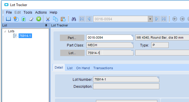

When we click on the Lot Number, for sure the Attachment icon is clickable but in the Tree the attachment doe not appear. image
This is different in the Lot Entry when the tree changes appearance.
Not sure how to explain this to the end users…
