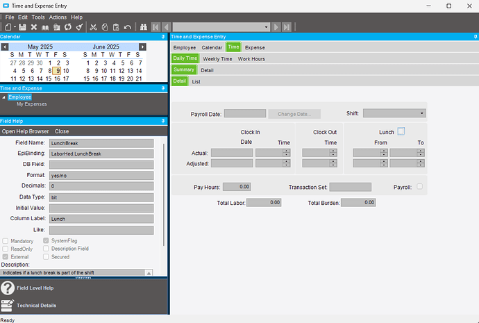

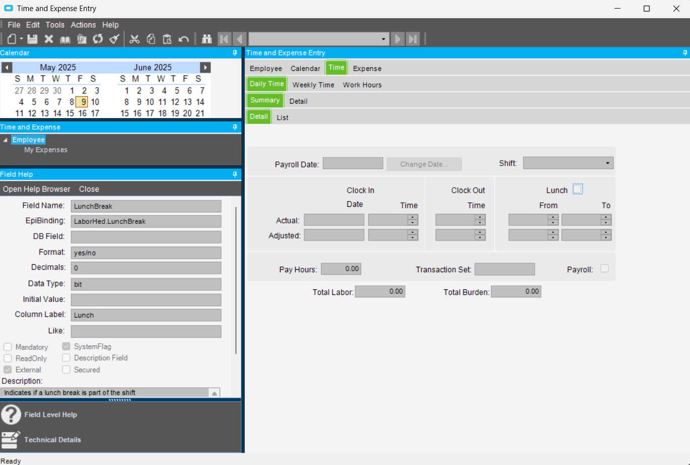

Wondering which data table the lunch checkbox is stored in? Trying to create a BAQ that displays user’s clock in information, some of that including whether or not the check box in Time and Expense Entry is checked for each daily log.
It’s not a dB to my knowledge. It just enables the lunch start/stop. You could build your BAQ based on if LunchInTime/LunchOutTime have a value.
Is it possible that it is defaulting from the defined Lunch that is shown on their assigned Shift?
When you have lunch set on the shift, if they clock into that shift during the defined lunch period, it will auto check the lunch box on the time and expense record.
