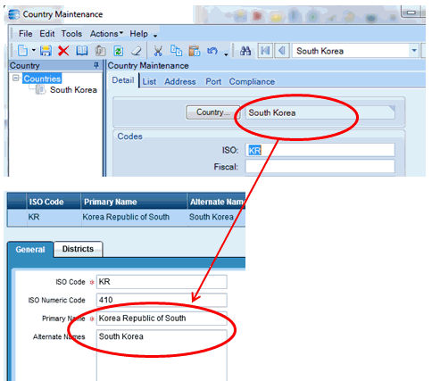

The Epicor Manifest Edition Country description does not match the Epicor ERP Country description. The Country Name in the Epicor ERP must exactly match the Epicor Manifest Edition Country Primary Name OR Alternate Names.

Example of Country codes needing to match:
