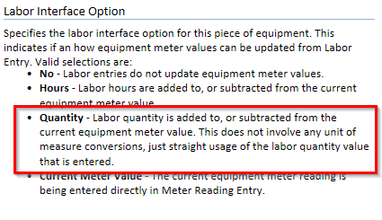

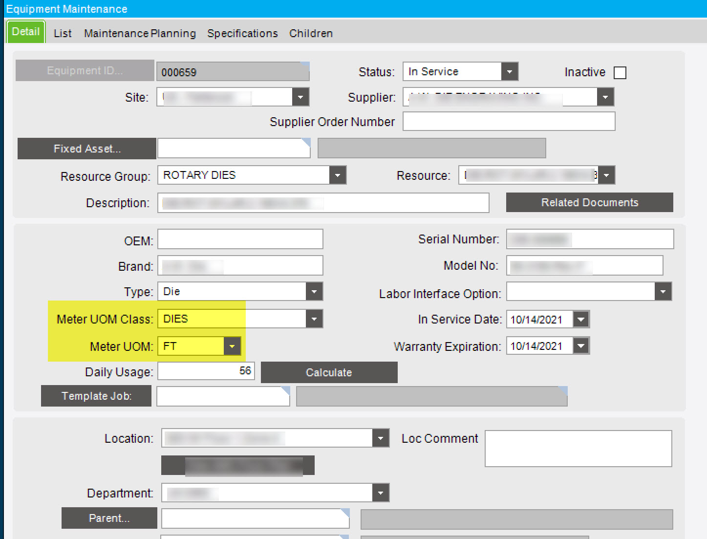

If you set the Labor Interface Option to “Quantity” it will apply to the meter automatically from labor reporting.

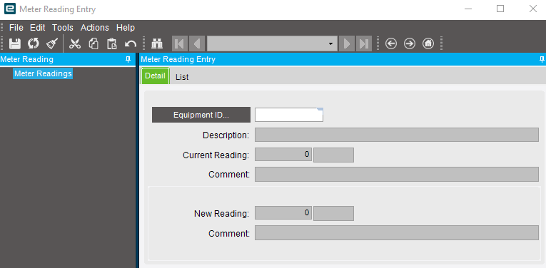

Alternatively if you have any way to read meters from machines hitting the MeterRead endpoint is really really simple to update the value.

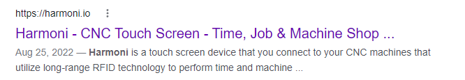

I saw a really cool demo of a product called Harmoni that links machines with epicor. I bet it could do all the automation.
@gingerhelp
I googled that with and without “automation software” and couldn’t find anything industrial do you have a link?
Only thing close I found but their site seems all but defunct?
That was it!!! Thanks Joshua!
Hi @jgiese.wci - that is the correct site for us. Did you have any troubles getting it to pull up for you? We are definitely alive and kicking over here at Harmoni :slight_smile:
I went back to it and now it’s loading fine. The first time I went to it and browsed none of the images loaded and only have the text that is there now loaded.
¯_(ツ)_/¯
Thats the site Josh.
That’s pretty fancy! Can anyone say how this differs from, say, MATTEC/Advanced MES? I see that there is a physical computer attached to the machine. Is that the biggest difference? Does anyone currently use Harmoni with Epicor?
