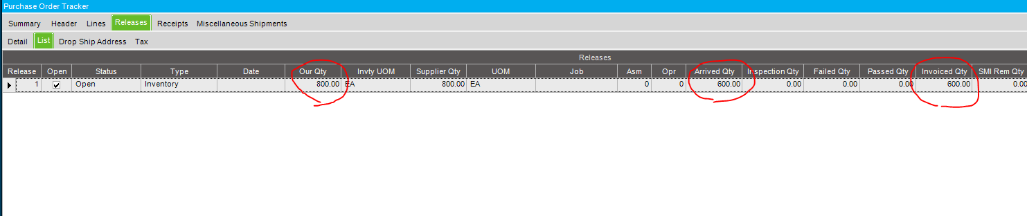

My user is performing the following steps.
  1. User receives a PO for 600 of part A
  2. User then opens up AP invoice add receipt billing lines entry and selects the original uninvoiced receipt line, except the line is for 800 of part A.
  3. The user then changes the invoice information supplier quantity to match the amount in step 1 (600)
4.This process causes the line in purchase order tracker to show the full 800 invoiced instead of leaving 200 remaining. She needs this to be reduced down to the remaining 200, I’m just not sure where in the system an end-user can pay a partial invoice quantity.
In Purchase Order Tracker, go to Releases Tab and look in list.
You should get a line saying the arrived Qty, Invoiced Qty. From my view they should be 600.
If the invoiced qty is 600, then the invoice amount should be 600 x unit cost. You can make the full payment of that invoice.
If more goods come later, you can do another Receipt Entry, e.g. 200. Then the invoice should only be 200.
If you do not want the 200 remaining, you can close the PO.
