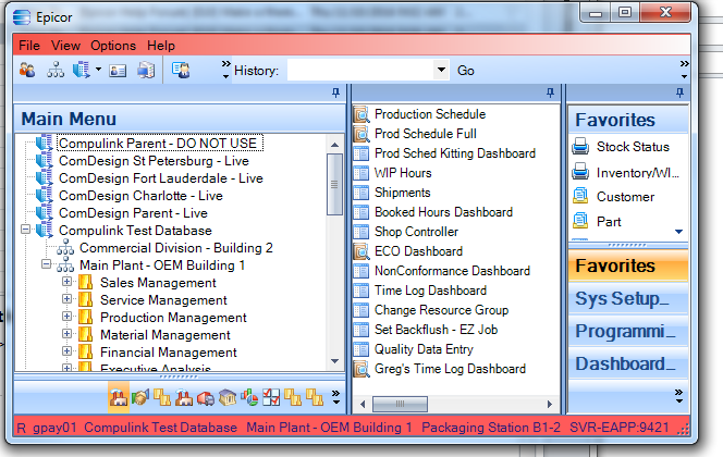

Here is my sql script I use when I replicate Live to test in E9. I got it from the yahoo group some time ago. I set test to a red theme, so the users know where they are. I assume it will be different for E10, but this should point you in the right direction.
Attached is the isl file for the red theme.
Greg
