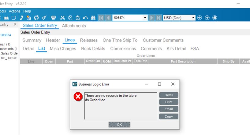

When adding a new line to an order, even though there is an attachment in the OrderHed I get this error:

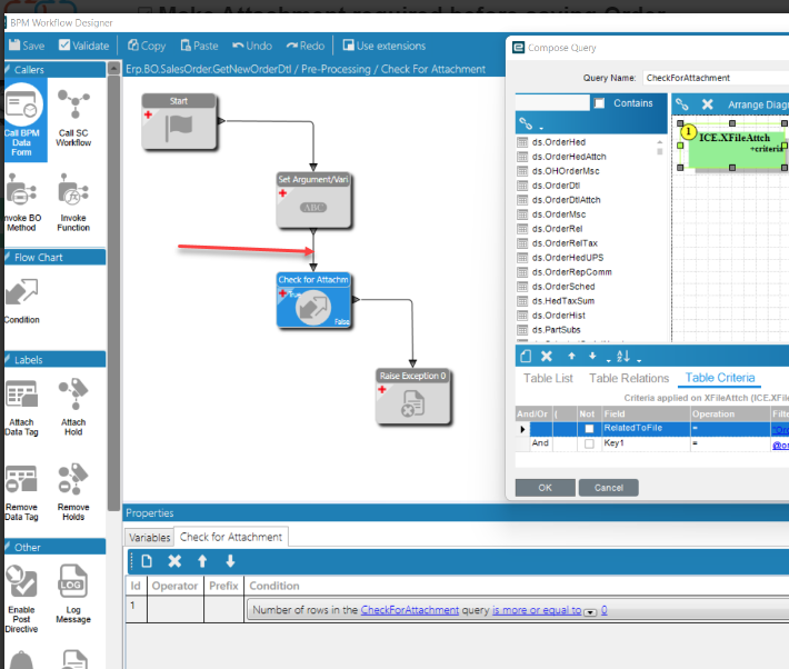

What method did you put this BPM onto? Do you only want to check for attachments when the SO Header is created or at each line added?
I put this into the Pre-Processing for Erp.BO.SalesOrder.GetNewOrderDtl
I want to check for attachments right at the start before entering the first line but once the order number is generated
Possible there isn’t a SONum yet on that method. setup a BPM that’d display a message box with the data you need to pass into the BAQ (Company, SONum, etc) to see if the data is available to you at that point.
at what point and method would I have this BPM run to display that data?
Do the “troubleshooting” Message box in your BPM. Don’t connect up and widgets that aren’t working, like that BAQ one. I’d connect it where I pointed and disconnect the rest of the BPM widgets.
This is important for debugging. I always have a message box setup to show common variables I am using, and the table view of any datasets I am using. I put it in just before the first widget that I think might be the problem one, and make sure not to connect up the problem widget. Then just connect one at a time. Keep moving the message box to the end of the line and eventually you will find the place where it breaks.
