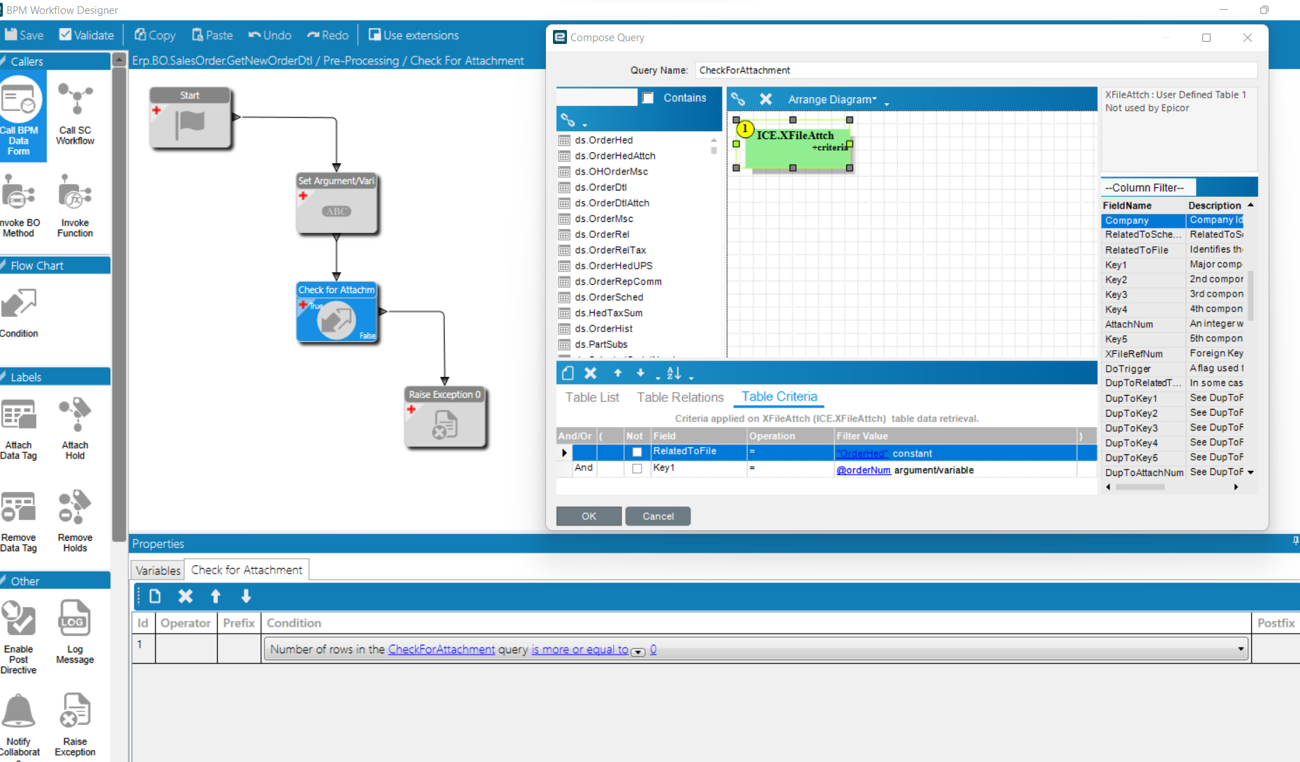

In pre-processing use a query to check if there is a related attachment. Then error if not.
I would put a condition on Update and use a condition widget using Number of rows in designed query is more or equal to 1. The query would look at Ice.XFileAttch. If wanting the PO attached at the Header you would use RelatedToFile equals OrderHed and Key1 equals OrderNum. You can join Ice.XFileAttch to Ice.XAttachMetaData to find specific attachment types

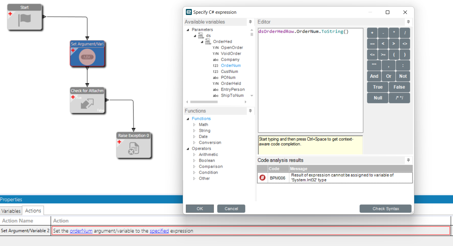

I would create a variable within the BPM named OrderNumber as a type string. You can then use a set variable / argument and set OrderNumber to your tt.OrderNum.ToString(). Then in the BPM Query you can just use the variable and this also avoids the pitfalls of having the tt table joined in the query.

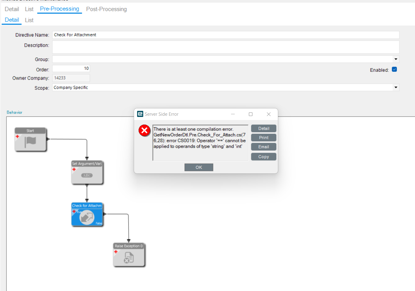

Ok that was the route I was going, but was still getting an error…so I think i am doing something wrong. Compilation error I am getting is:
BPM is set up as such;
Put double quotes around OrderHed in the criteria
Ok that stopped the error in compiling!

I get this error. Did you as well? If so, how did you fix it?
Take off the ToString() - it appears your OrderNum variable is an int.

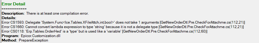

That resolved that issue, but now when I enable to the pre-processing I get this error.
Whats the code for your condition widget?
I see what you were going for. Key 1 is a string, so you wanted to convert your order integer into a string. Which ever way you go, make sure they are all the same datatype all the way through. Take a look at the datatypes for each widget and variable.
orderNum is set to default type System.Int32
