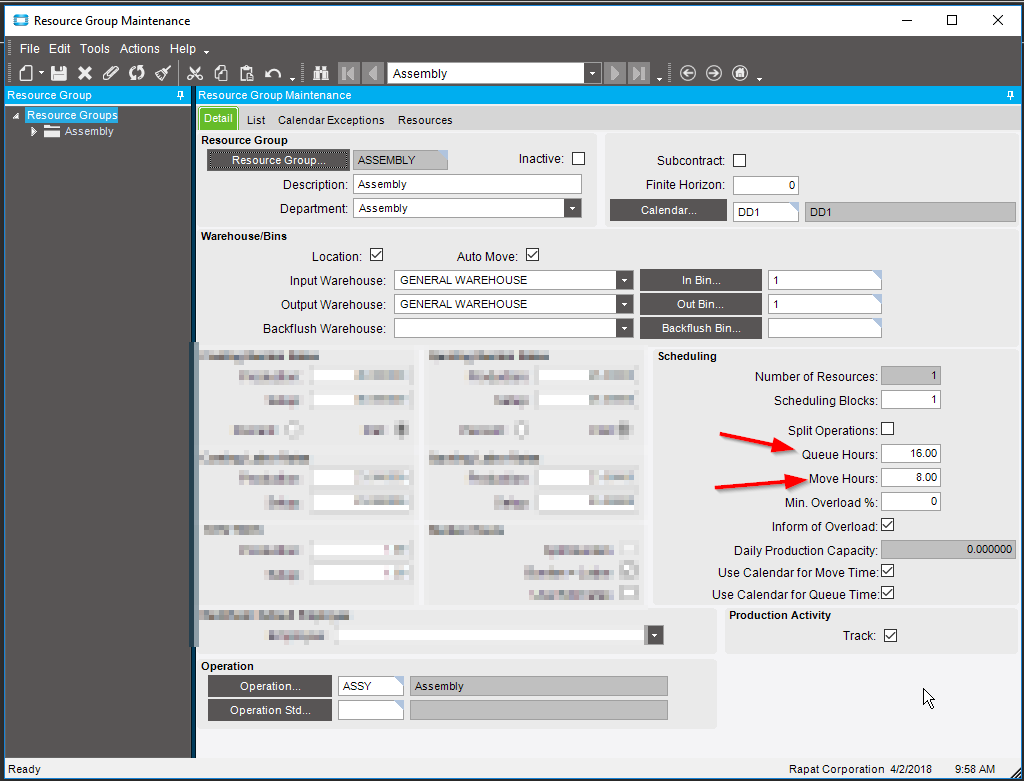

You can add queue hours or move hours so that it doesn’t add it up as labor hours, but still spaces it out in scheduling.
Thanks for the fast response @Banderson. The time to dry varies significantly based on the size of the part, so I cannot use the move time.
That’s the only way that I know how to add time without adding labor time. Off the top of my head, could you make categories that would get it close enough? Like short med long, or based on part size? or time range?, etc, then apply the operation that you need for the part? Depending on how you are doing reporting that can make things painful, but if it’s a back flush operation, then maybe it wouldn’t matter. Just one possible solution.
