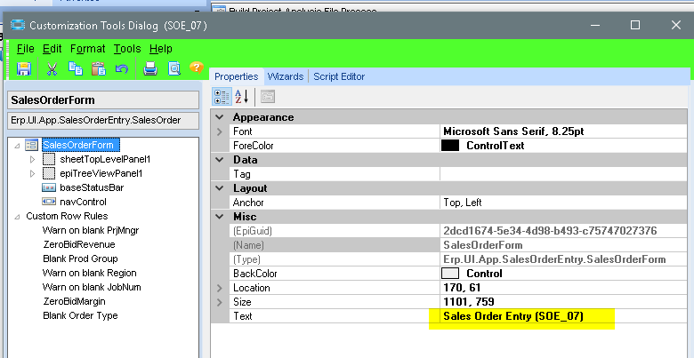

First off, to ensure that people are seeing the right screen, I always set the Window Title to include the Customization ID. Like:
which yields:
Then you’re certain they are using the correct one.

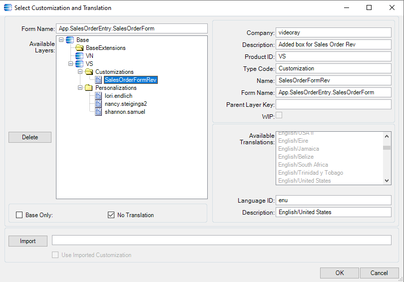

As you can see from the Order Entry customization selection, user dgartner had personalized customization SOE_05c, SOE_05d, and SOE_06.
If SOE_06 was the currently used custimzation (as specified in Menu Maintenance), and I made a new customization SOE_07 (which was then set for the menu item), then none of her personalizations from SOE_06 would be in SOE_07.
